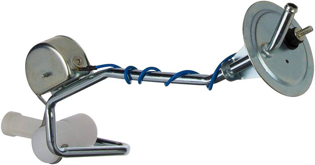

    Getting ready to buy a gas tank, gas tank straps and gas gauge sending unit. Been reading lots of comments on problematic Chines made sending units. Has anyone bought the sending unit listed below which is listed on eBay? He does not say its a USA made part but he does imply it in the description.

    Looks identical to the FG148A Spectra piece. Not surprising because I'm sure they don't make them, they just resell them.
    Half the price other places, although a quick search showed it out of stock at places like Amazon (where I bought mine)
    I've never had one done, but if you are willing to spend that much, have your old one rebuilt. Classic Vintage Page Bet it won't be any more $$. It might even be less.

    Most likely any sending units are probably made in China or Taiwan. My son just put one in a 75 Dodge truck. He had to bend the tang with
    the float as I watched fuel gauge in the truck to try to make it accurate. He also repaired the plastic tank with a soldering iron and pieces of
    plastic oil bottles. I think there are tutorials on U-tube for the tank repair. It cured the leak.

    I purchased one for my '70 Fury III Summer of 2019 from www.VansAuto.com
    However I would call them to double check.

    They have 10 available on eBay. VansAuto is the eBay listing I posted above. I'll also be getting my gas tank from them.

    That one on eBay looks like a Spectra product/ I just put one in my 68' 300. It was made in Mexico. The ohms was correct but my guages or the mechanical volt limiter was playing games so I purchased and installed the MeterMatch product. All good.

    Van should be good for both tank and sender. Ironically enough, I got a sender from Van several years ago, then got the new one last year from these folks: eClassics 1962-1965 Chrysler Newport Stainless Steel Fuel Sending Unit 5/16"
    and the gauge from Auto Meter (MADE IN U.S.A.!) that made all the magic happen! Ironically enough, the gauge previously purchased from Van worked just as well with the Auto Meter gauge. I tested it one last time, thinking I was going to consign it to the scrap metal barrel and Ecce! it read FINE! So, I have a spare...
    I suspect both of my fuel sending units come from China. Be this as it may, they have nice brass floats, read consistently and with a good gauge, ACCURATELY! The sino-crap Equus gauge I had earlier just saturated as soon as anything more than 3VDC went through it.
