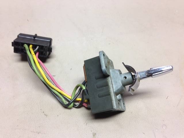

Nov 17, 2016 #1 carrman Senior Member Joined Jan 1, 2011 Messages 1,094 Reaction score 939 Location Medford, OR Anyone ever done it? Seems '67 has a pigtail, and '68 has male spade connectors on the back. Help?

Nov 17, 2016 #3 commando1 Old Man with a Hat Joined Mar 10, 2011 Messages 37,380 Reaction score 38,544 Location Sebring, Florida Notice that 67 and 68 switches are the same - Male spades. You're looking at a switch with a pigtail connector that connects to the main harness.

Nov 17, 2016 #4 carrman Senior Member Joined Jan 1, 2011 Messages 1,094 Reaction score 939 Location Medford, OR No. Apparently '67 has a switch that has a switch like this:
Nov 17, 2016 #5 carrman Senior Member Joined Jan 1, 2011 Messages 1,094 Reaction score 939 Location Medford, OR I guess not all '67s have the pigtail directly connected to the switch?
Nov 17, 2016 #6 commando1 Old Man with a Hat Joined Mar 10, 2011 Messages 37,380 Reaction score 38,544 Location Sebring, Florida Wiper switch and Headlight switch look alike.
Nov 19, 2016 #7 traintech55 Senior Member Joined Jul 23, 2015 Messages 4,476 Reaction score 5,841 Location Hammond, IN. Also remember Chrysler unlike other auto makers would make mid year changes to parts that did not hold up as expected. Check the end that plugs into the main harness, if the ends are the same use the newer switch.

Nov 19, 2016 #8 commando1 Old Man with a Hat Joined Mar 10, 2011 Messages 37,380 Reaction score 38,544 Location Sebring, Florida Best example of why you need to own a copy of your car's Parts Book. P/N's answer 99% of the questions.

Nov 20, 2016 #10 MYSINBIN Well-Known Member Joined Apr 24, 2015 Messages 539 Reaction score 458 Location New York FWIW, I have both types pictured in my '67 Newps. John
