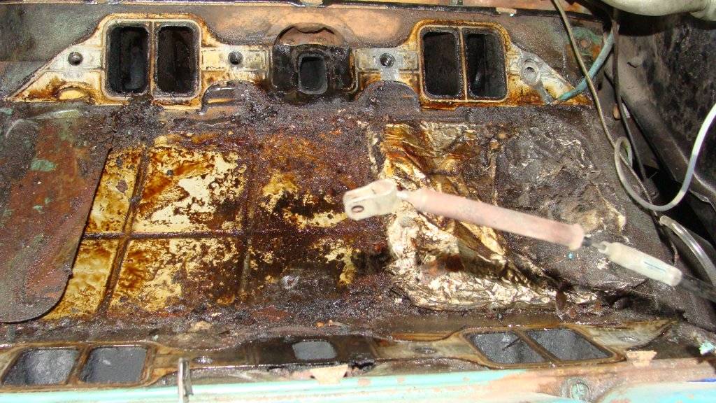

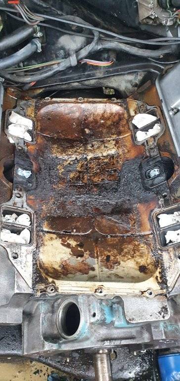

What is the valley pan covers function? Is it necessary?
PS: its approx 4x6 piece of steel that bolts to front of valley pan.

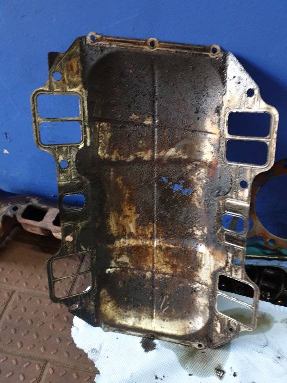

It holds the valley pan ends to the block. Helps align the valley pan with the intake runners in the cylinder heads.
Im not meaning the bar. I have a piece of sheet steel about 4x6 that attaches to the 3 front bolt holes under the bar and protrudes over the valley pan.

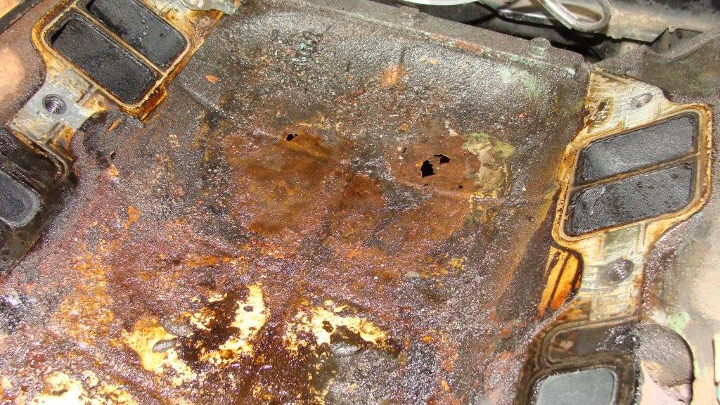

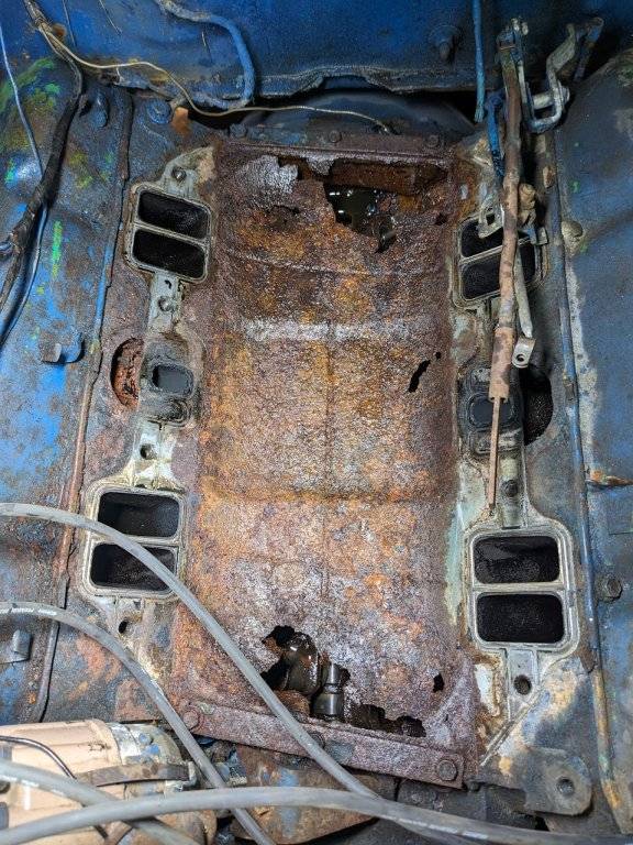

...and I thought mine was the only rusted thrue one...
Performance Car Graphics has it available. I will be getting some once I put a few miles on my Imperial. It helps reduce heat transfer to the intake and muffle noise from the valley.
