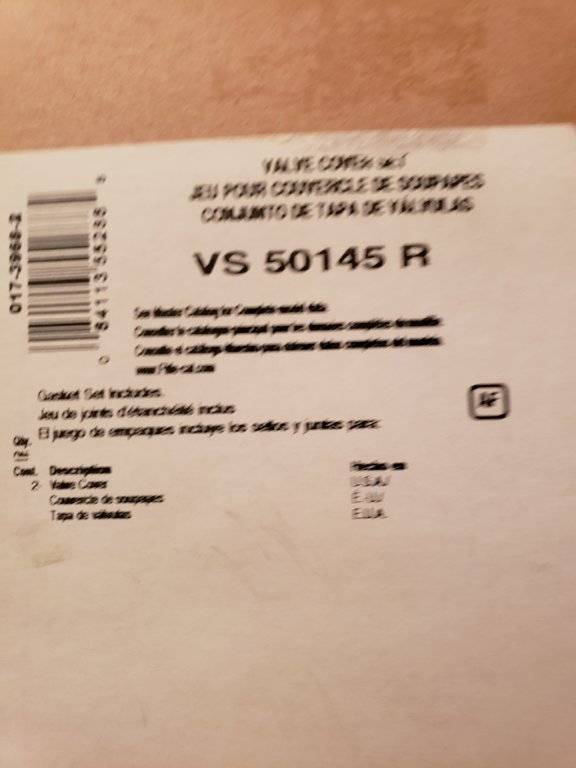

    I have used these FelPro VS 50145 R Hi-Performance valve cover gaskets for a 1969 R/T 440 for decades and never had one leak. They are black fiber constructed. They don't move at all during installation. I use a light coat of adhesive just out of habit.
    • Thanks! Thanks! x 1
