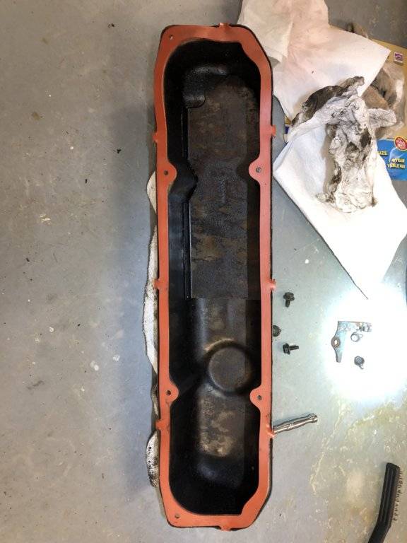

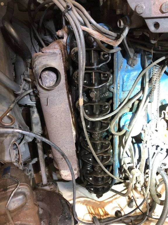

    My 74 Fury has two valve cover gaskets that drip oil onto the exhaust manifolds and make a stink. Reading through other thread multiple people recommended Real Tennessee Gaskets so I’m giving them a go.
    Started on the driver’s side last night. I figure I’ll drive it for a bit with one side done before I decide to do the other.

    The red gaskets were designed to solve the problem on big block mopars with the VC gaskets burning out over the center line exhaust ports, this was a big problem on police cruisers that did extended high speed chases. Adding a coat of aircraft grade Permatex to each side of the gasket will further aid in sealing. This style gasket is the best currently available option.

    The gasket that was on there was a cork one in rough shape.

    I found I had to trim the tabs on my Tenn. gaskets.
    Was this your experience as well ?
  5. jason99
    jason99 Well-Known Member
    Messages:
    516
    Likes Received:
    202
    Joined:
    May 20, 2018
    Location:
    Atlanta, GA
    One tab required a minor adjustment.

    That's what I like, a man that has no confidence in his work!

    I agree, and do that regardless of where the gaskets come from.

    Drivers side was solid during the inaugural idle in the driveway and gas station run. I doubled down and did the passenger side and should have some time to take a ride tomorrow.
