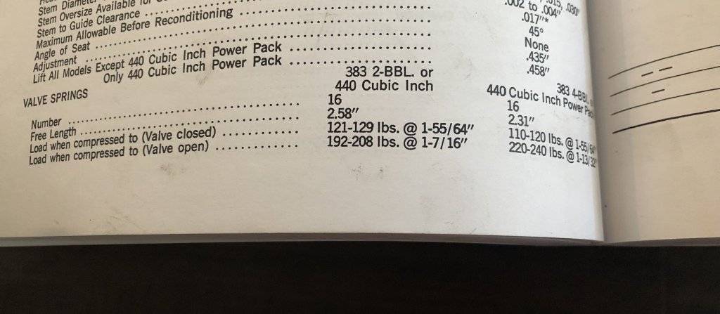

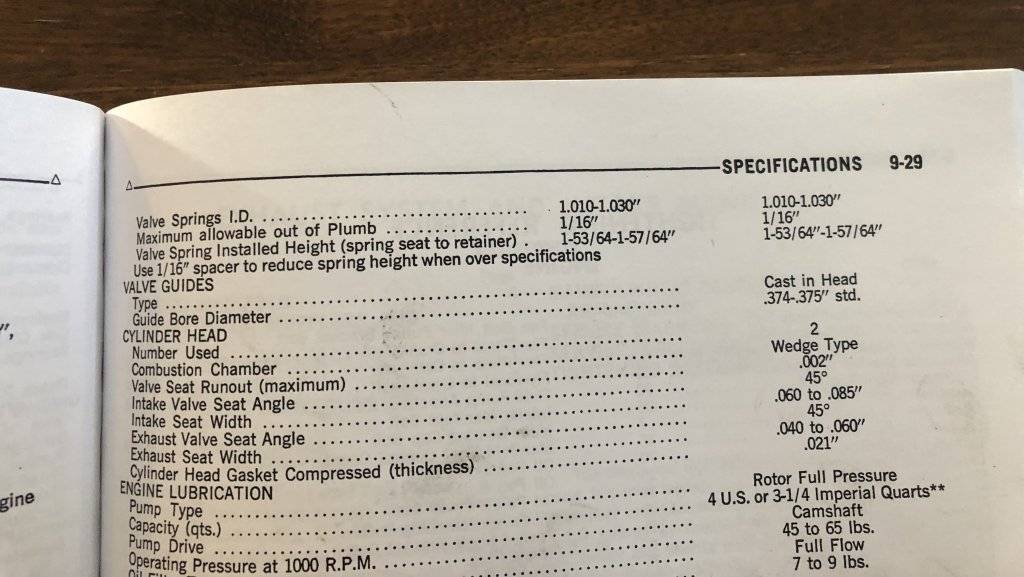

This is my first post. I’ve pulled the 440 engine in my 1968 Chrysler 300 due to a few oil leaks and I had just purchased the car 2 years ago from an older guy who hadn’t run it for years. Everything is in pretty good shape. It looks like the timing chain and sprockets, camshaft and lifters have all been changed but I think they re used the old valve springs. Several of the springs had multiple shims added. So I am needing to replace the valve springs and valve seals. I’m having troubles finding valve springs that have the original specs. They all seem to be much stiffer. These are the least stiffest I could find. Will they work? COMP Cams 924-16: Dual Valve Springs Outer Spring O.D.: 1.509 in. - JEGS High Performance
I’ve included the specs from my service manual.

If I was you, I would leave the springs alone for now. It sounds like they were previously set up carefully by someone in the past when the lifters and cam were changed. If the valves aren't floating at high rpm, the springs are fine. And yes. you can just delete the heat riser. I did this with the 440 in my '66, and since I don't drive the car much when it is very cold, it is not a problem.

Yes if you have shims under some of the springs that means someone took the time to check spring tension and did the job correctly. Most engines I see they just slap in the cam and lifters and springs and never check them. Then they wonder why their "built" engine can't rev higher than 5000rpm. I agree with Rip if you are not having high (above 4500 rpm) misfire issues I would leave them alone.

Shims are often added after a valve grind, that would be normal procedure. Shims help compensate for the material removed from the valves and seats as part of the grinding process to keep the valve tension where it should be. Sounds like somebody did the job properly, so leave it alone unless you are having problems as noted above

Anybody with a proper valve spring tester can re-shim things as needed. BUT unless you might have done it before, probably about the only place you might find a proper/traditional spring pressure tester would be at an automotive machine shop.
Even if you bought new springs, they would need to be checked prior to installation, typically. Best to use what you already have.

The shims are there to get the proper " installed spring height"
I wouldn't get real excited about them unless you plan to be over 4000 rpm on a regular basis.
Yes they are part of a good valve job, but you either need to get access to a couple of special tools or take the heads to a shop and have it done.
