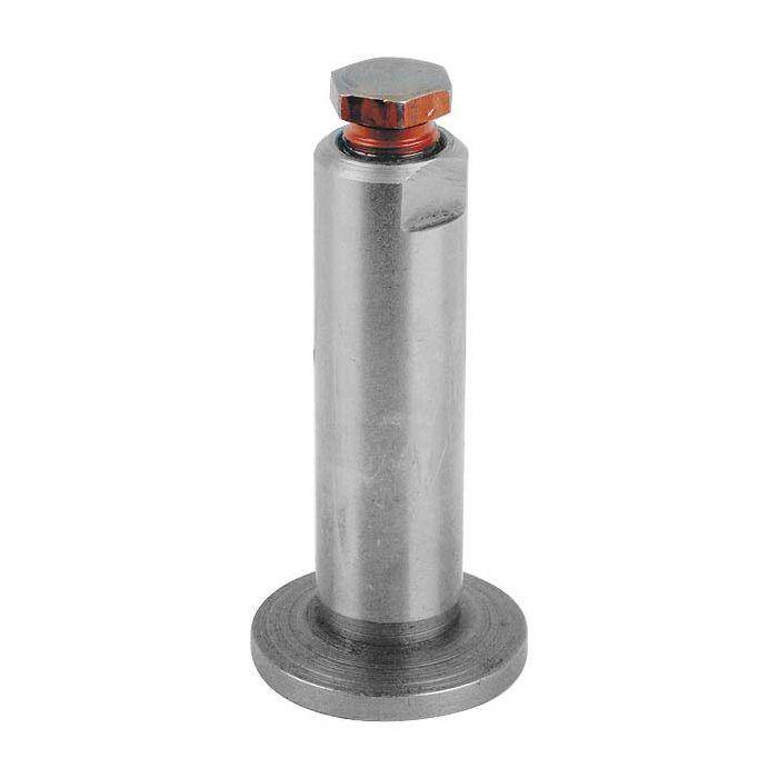

i always understood tappets to be pre-lifters. like in a flathead ford or side valve engine.
i thought that the old timers just carried the name over to the new fangled lifters.
