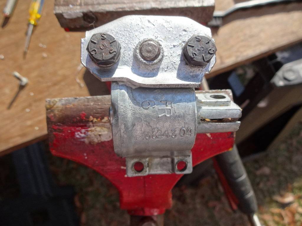

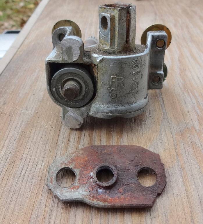

I'm thinking the plate on the back of your regulator has come loose or pushed off. It's not a uncommon thing and is repairable.. Your going to at least have to remove the trim panel.
Here is how I repaired mine......
You may need to feel around the bottom of the door to find the plate is it had come off.
Before.......
After....
Before.......
After....
Cool fix!
Before.......
After....
So was their threaded studs and you just drilled and tapped holes for bolts?

My car had been in long time storage. The rubber seal in the vent frame had "curled" over and the glass did not seat well causing someone in the past to try to force it closed with the crank causing the rivets to Strech and break. I had to correct the seal issue also.
