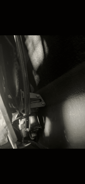

I try to remove the vent wing motor from the left front door (motor is stuck). In the shop manual I read that the motor shall be removed through the large acess hole. And theres my problem: the chanels/track for the window is in the way! How do I solve this?
Gustav
Hard to see in the pic, but it looks like you've already removed the motor from the bracket.
I'm trying to remember how I did mine... It seems to me that I loosened the lower track mount (the one that goes through the bottom of the door) and just pushed it out of the way. I know it didn't take much to get it out. That is an adjustable mount so you want to look at where it was so you put it back where it was.

Thank You! That sounds like a god idea. They should have written that in the shop manual.

The easiest way to remove the motor is to remove the motor from the bracket, NOT remove the bracket from the door. If you remove the motor and bracket as a piece, it wont get out from the door.
