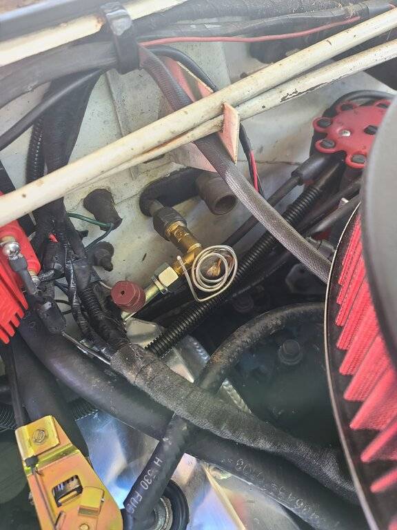

    Maybe the 'simple' solution would be to keep the underdash stuff how it is and hook the ac components up to the original evaporator?
    Since there was nothing left in regards of AC vomponents in the engine other than the two pipes sticking out of the firewall, how would I go about fitting an expansion valve to this system?

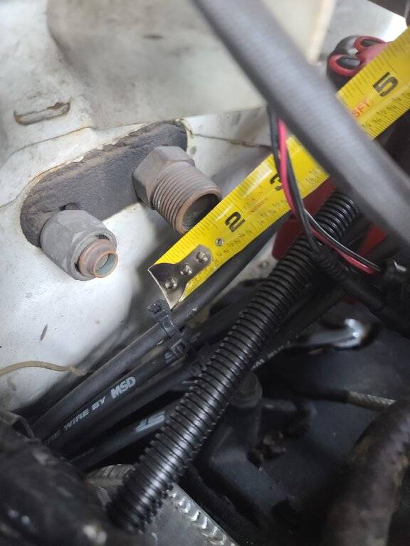

    What size fitting is this? All the ac hoses and such I find have only 6 and 8AN on them... this looks quite large like 1".

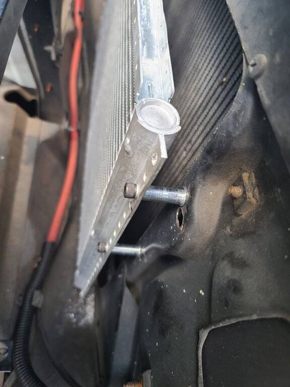

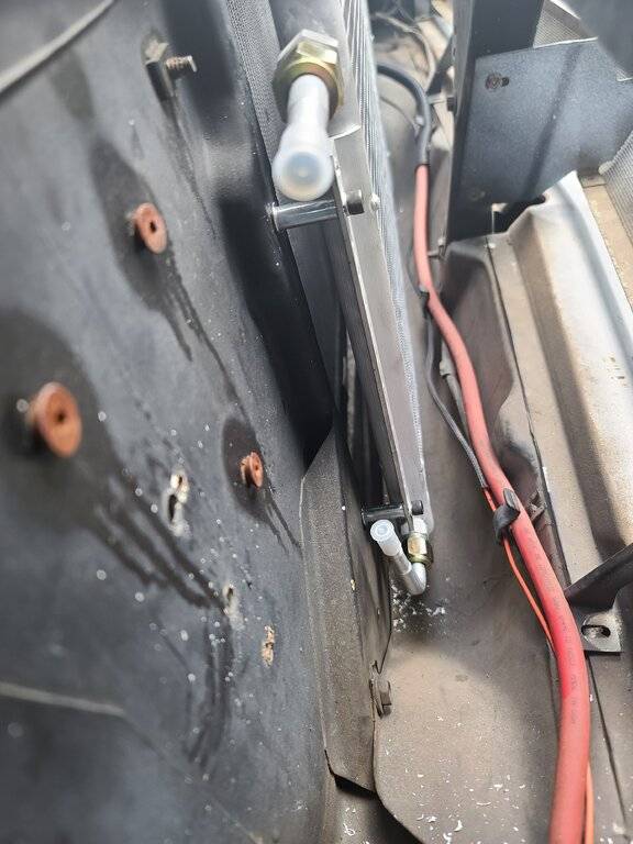

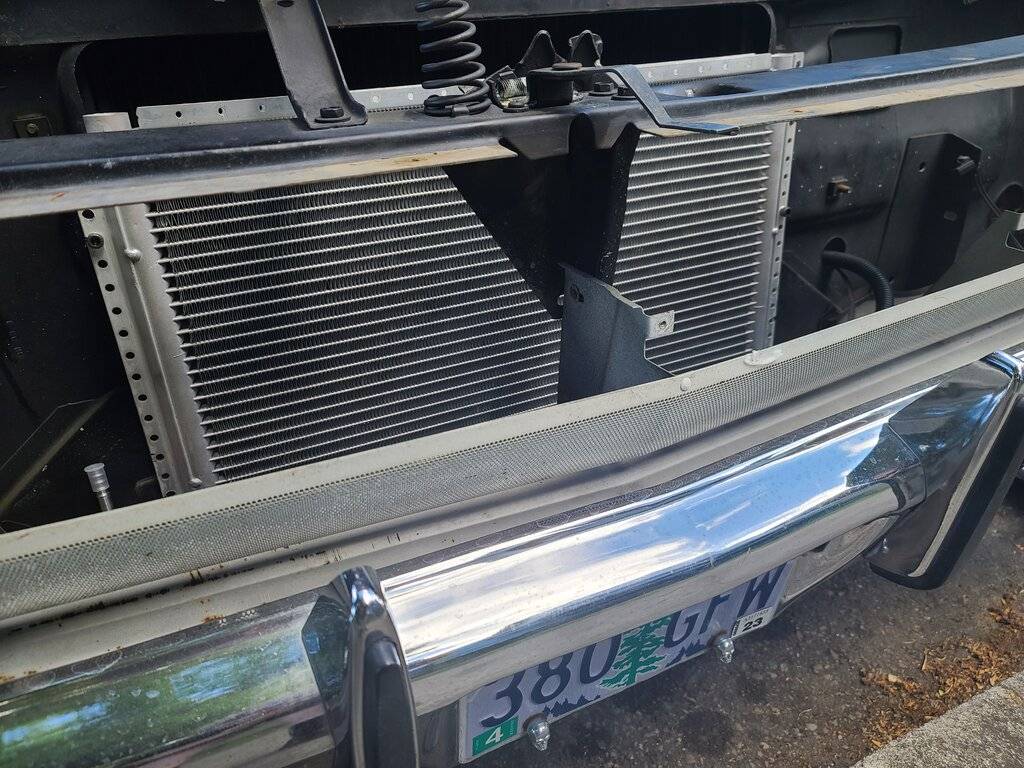

    So far I have put a condenser in. I have to mount the dryer still and I have a custom made hose coming for the high pressure side. Once I have that sorted out, I'll tackle the compressor and mount. Then I'll have to see how to adapt a suction hose to that huge fitting on the evap...enentually it will come together. Once its all hooked up, I'll have to tackle the electric to use the dash AC sqitch to turn it on...

    Ace hardware. 1/4 screws, aluminium spacer and I did rivet threaded rivets into the radiator support. I already mounted the dryer too and should have one of the hoses coming today. I'm debating if i need to use a small fan for the condenser so my electric cooling fan runs seperate from the ac fan
    Edit: i screwed up a little on the custom hose and didn't order the charge port 90° offset. However, I can still use it like that... I'm just mocking things up...still need to flush the evaporator.

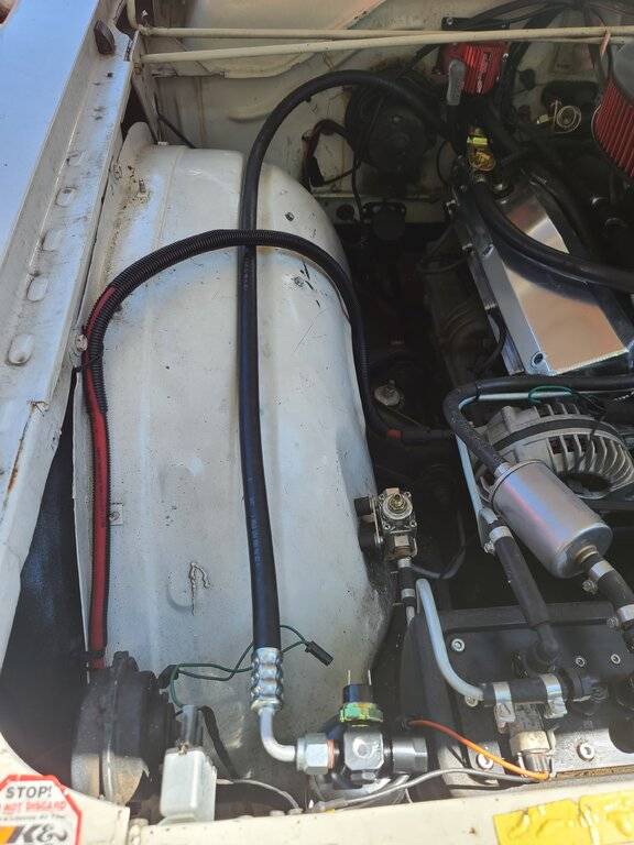

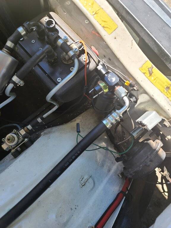

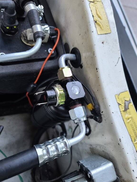

    Got a little further in hooking up the hoses. Now It gets to the expensive part finding a compressor and the bracket for it.

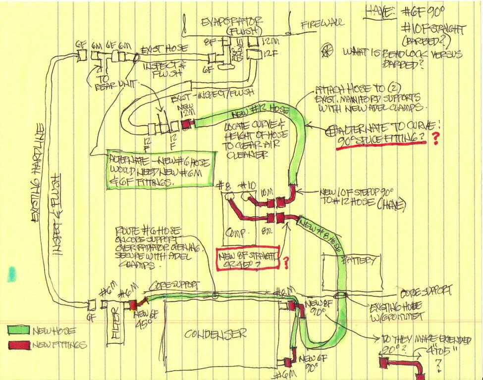

    One thing that helped me when I was planning out my hose routing and buying components was drawing a diagram showing high and low sides. My setup was pretty complicated because my car has dual air and I had to connect the rear unit into the lines. One thing to consider when planning your compressor and bracket setup is a premade set of hookup lines with both charge ports built in - this is what I used.
