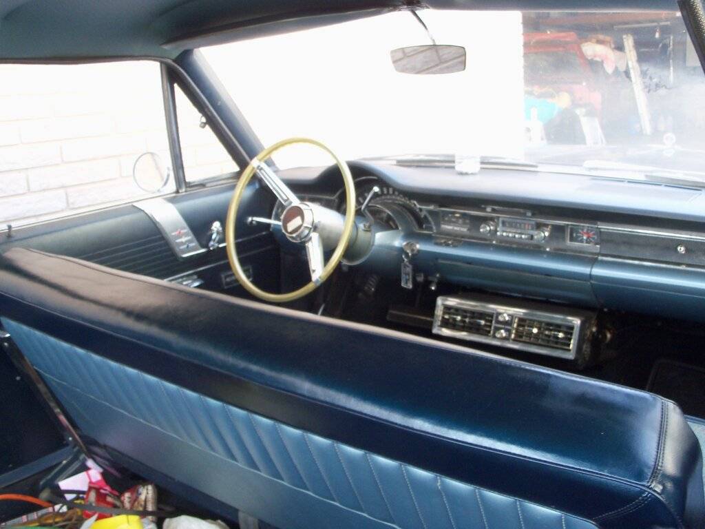

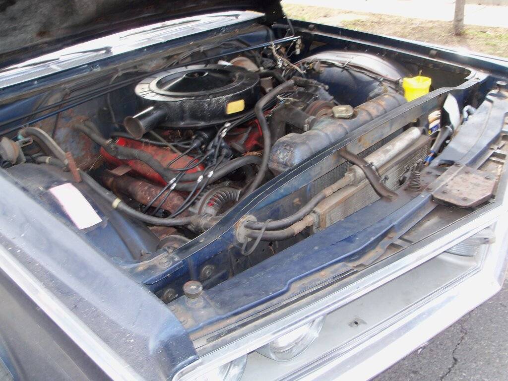

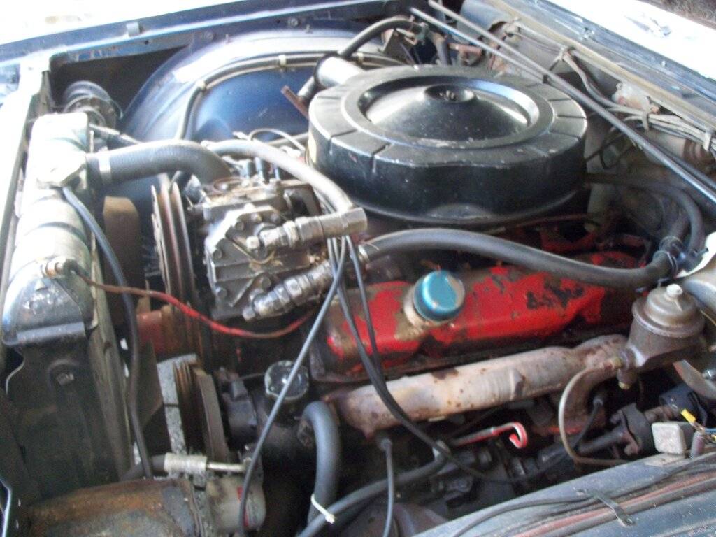

In 2013 when I got the La Chrysler in my shop,it had the knee knocker dealer installed AC unit.
Still had the factory 34? 36? amp alternator and no fan shroud,factory fan and 22 inch non-air radiator,
At that time the car had 252,000 miles on it and based on the owner's recollection it did not overheat nor had any charging issues.
Obviously,the ac had not been working for years.
