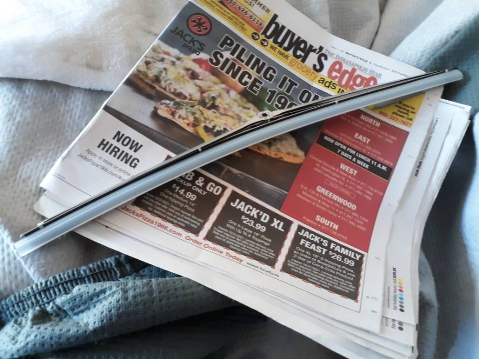

So after spending a day snd a half trying to find a vintage 16" trico or anco wiper blade for my 70-300 I have come to the conclusion there isn't a cheap repop available. The anco 2889859 refill changes up to something other than the satin finish metal blade.(20-16 anco #) The longest Trico I can find is 33-150 15" in the correct style.(Napa # 60-1537) so.......what is everyone doing for correct blades on their fuseys??

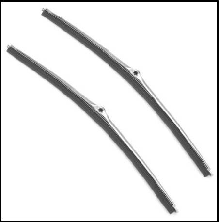

Looks like these repos might work, at least on a 1971 (P/N 3431465 ):
''Hideaway'' windshield wiper blades for all 1969-71 Plymouth Fury; all 1969-71 Dodge Monaco - Polara; all 1969-71 Chrysler and all 1969-71 Imperial
Edit: I just ordered a pair for Medina, my 1971 Monaco. Will report on fit.

I have the original style wipers. The car parts store stuff hits the hood as previously mentioned.
I wonder if I can just buy a 16 inch wiper blade and take it apart and use the rubber part as a refill on my original setup?
That all I do. Replace just the rubber with that thin metal spline type thing. Some refills required pinching the little tabs on the wiper arm to grab the blade tighter.

You can buy the silver metal refills at any auto parts store. I did. They’ll have just one you’ll have to order the twin. Make sure and tell them how many cylinders your engine has and whether the car is standard or automatic.
(...) I just ordered a pair for Medina, my 1971 Monaco. Will report on fit.
The wiper blades were received one day too late to help me drive Medina to Carlisle in the rain. When the box was opened yesterday, it was found that one of the two wipers I had ordered looks perfect but that the other, unfortunately, has its blade bent to an angle.
--> I have reached out to Mopar Mall in the expectation that they send a proper replacement. Will report when it arrives.

I am happy to report that MoparMall stepped up to the plate and replace the bad blade. Count me a satisfied customer -- I will order more parts from them, as standing behind your products is a key component of customer service in my book.
