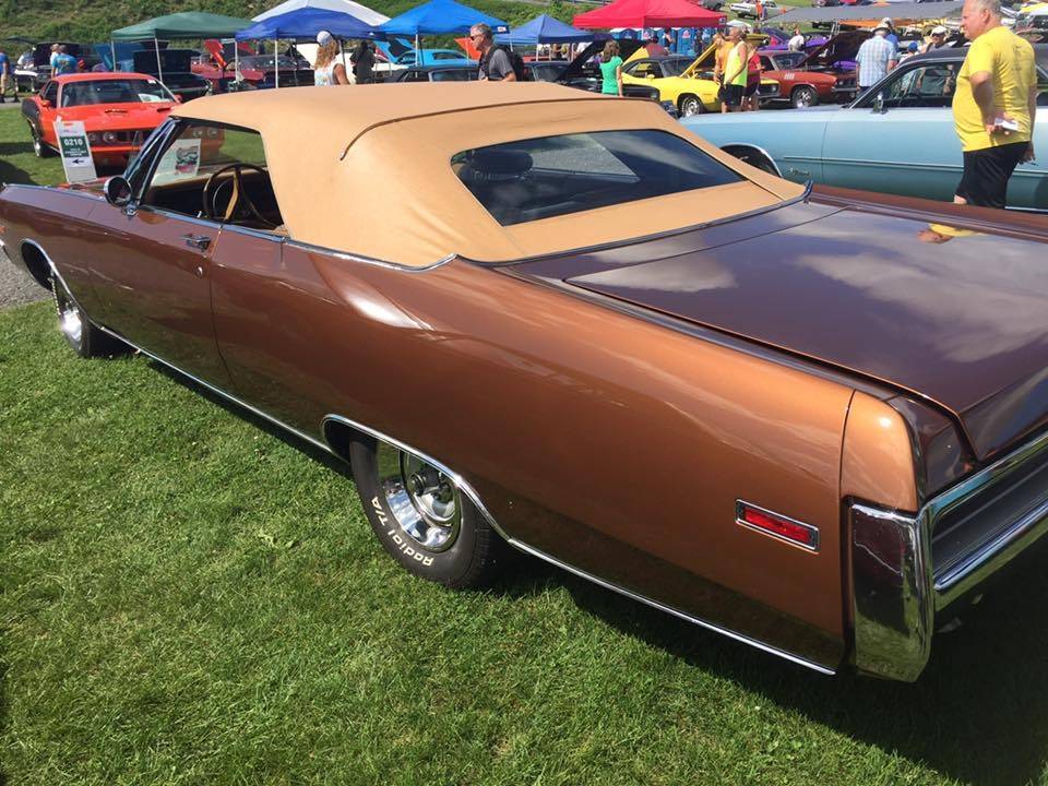

I use this on my convertible top and have been very happy with it. I'm not sure about runoff in the rain/washing the car because I don't drive it in the rain or use water to clean it.
www.raggtopp.com

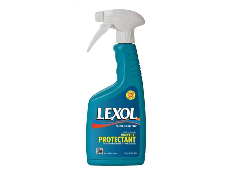

I use Lexol. Leaves a nice sheen and does not build up or wash off.
Call one of the vinyl top guys (SMS) and ask them what product they recommend for vinyl.
I'm going to give the Lexol a shot. I can find it locally, instead of having something shipped.
Thanks for the suggestions. I'll try to remember to update this in a few weeks.
