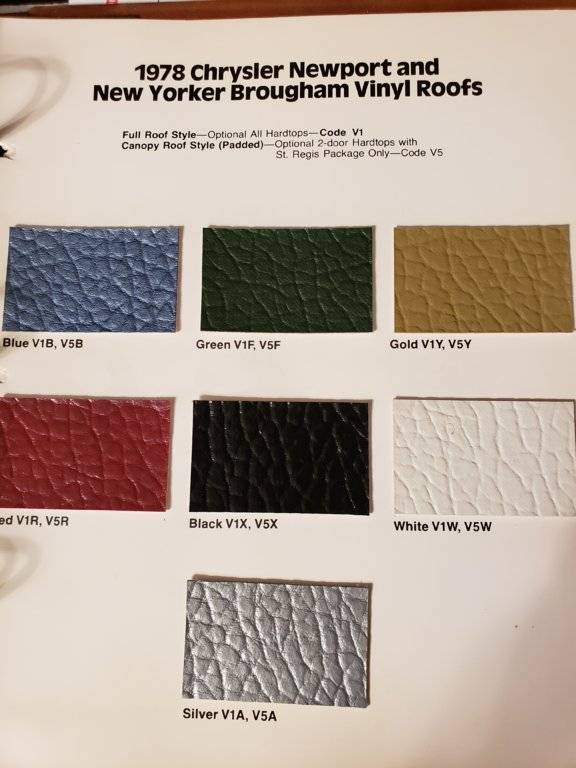

need to check grain on the 1978 Salon vinyl roof before I screw it up.
Is it elk grain or the pebble grain like the regular NYB’s?
Thanks!
Pebble and maroon:poke:
Elk is what I have on my '67 Imperial. I think they used the elk on the thick padded roofs. But I've been known to be wrong.. A LOT:lol:

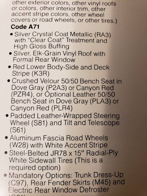

Jav, is the code for the Salon option A71?
Then it would be Elk grain....

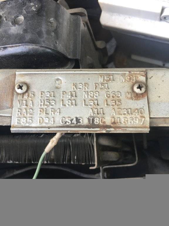

Jav, you probably posted your fender tag before....
Would you mind posting it again on this thread.
Thanks!
Bob,
Mine is not a Salon, but I like the look and it was what I was originally looking for when I started.
I have the rear window plug and interior trim.
The top on it now is badly blemished and is beginning to fracture.
As requested, here is the fender tag.
Bob,

My previous post lists all the options needed to do a full blown Salon.

Was the A71 Salon option only available for 1978?
I just don't remember....
It will confuse the experts....especially those that can read a fender tag. LOL!
The rear window plug and window I bought come with the defrost. So check as to that.
No leather wrapped steering wheel.... which is fine by me. Though I could wrap the wheel I took off with leather.
Interior the same otherwise.
Top... just reordered it in correct elk grain.
Wheels are something I never cared for on the Salon. Too busy for my taste and all fake with basicly a bolt on hubcap. I’m not a purist but I do have something in mind to up the ante.
Crystal silver paint with clear coat. Thinking about it..... paint on it now is so damned thin and it has a repaint on the driver rear quarter and the trunk that look really bad. I guess they saved a lot of weight by shooting the original paint so thin.
One thing at a time.
Heads for good measure first, then paint (maybe) then top.
