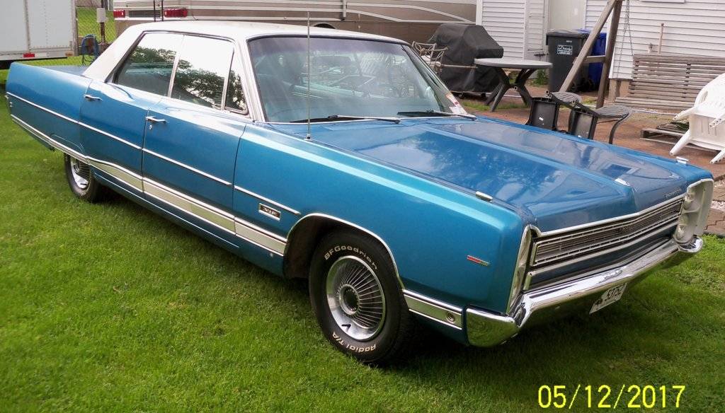

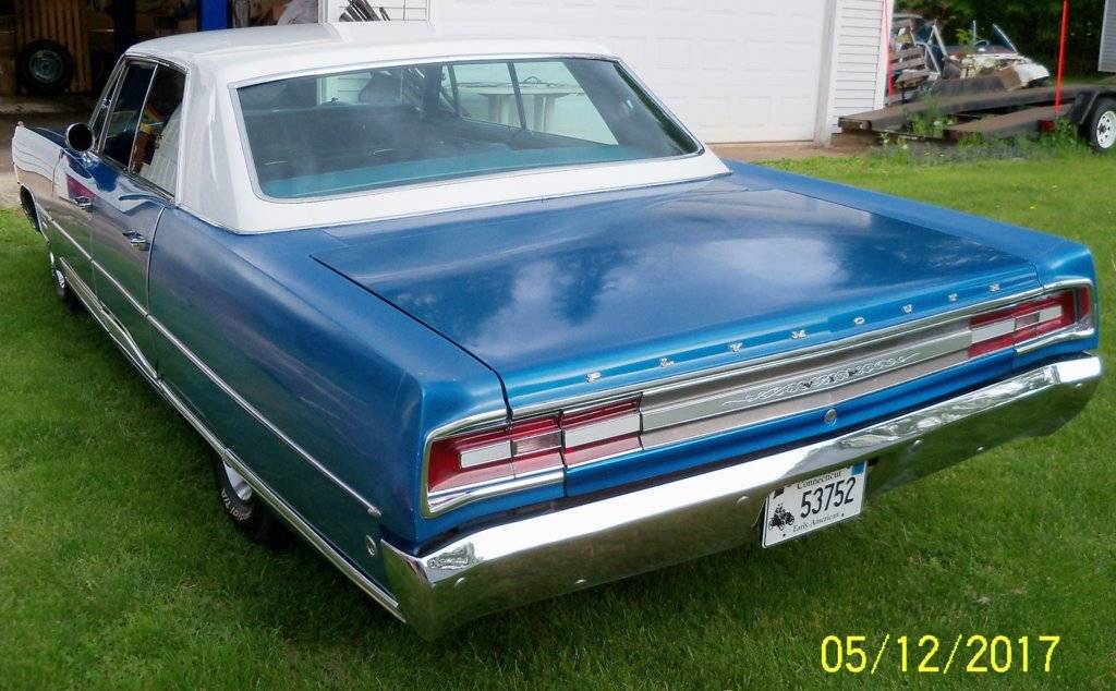

My former 68 VIP factory painted roof car.
