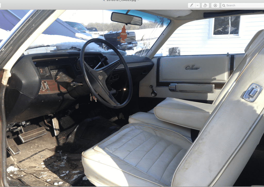

Here are the front seats back in September 2018, in a photo posted by the seller. The photo shows that there is no issue with the base of the driver's seat, and no issue with the back of the passenger seat. The rips are on the base of the passenger side (one large, one small, both at the seams in the middle) and on the back of the driver's seat (two, one at the bottom of the seat back and the other about 1/4 up from the bottom):

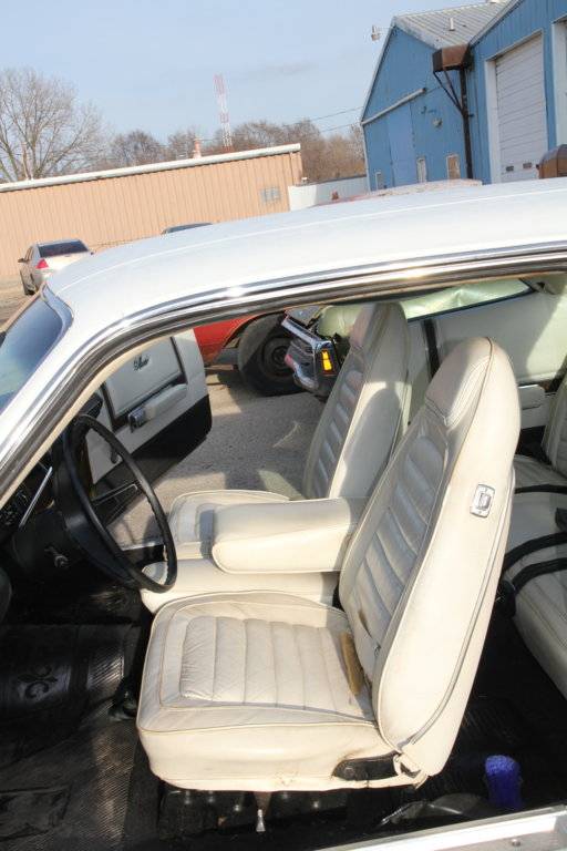

Here is how they were back in February, when I bought the car (photo courtesy @'69FuryIIIConvertible):

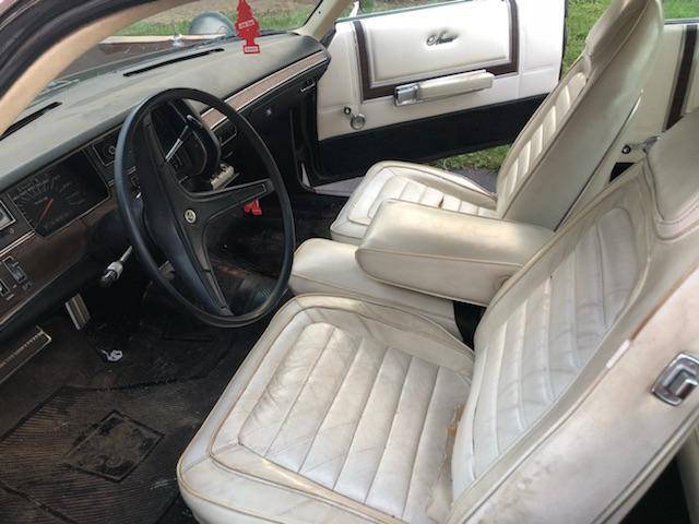

Here is the driver's seat in April, the base is still pretty much the same (no rips) as in February but the rips in the back seat have widened and foam has started to spill out:
As for now, the seat loo is how the seat is now, I thought I had a photo but I do not. In a nutshell, the bottom seems unchanged but the vinyl strip that broke on two sides 1/4 from the bottom is now permanently folded over, and foam is spilling out from there.
I could have the seats fully redone, but I was hoping to not have to swallow a large bill.

It looks like your center section is leather and the rest of the seat is vinyl, is this true? I'm sorry to say that your seats have crossed the bridge to far. They can be repaired, but with the patch of the missing foam, the size of the wounds and the repair needed, it will show a scar, how bad is the question? That would be up to the techs ability to do a great job. Seams are even harder to repair and make look good like you would want, it's just the nature of the beast sorry to say. I'm sure the Dr. [if there's one?] in your area would say the same.
If you can get skins from Legendary Interiors, get a set and DIY it, that would be your best bet. Foam can be patched and repaired by you depending on how rotten it is? I did it to my foam when I reskinned mine. Hog rings, Hog ring pliers, and a extra pair of hands helps make the job easy. I hope this helps?
