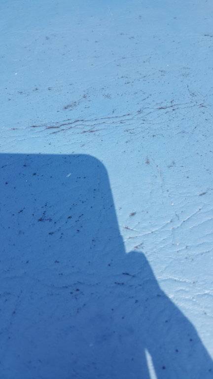

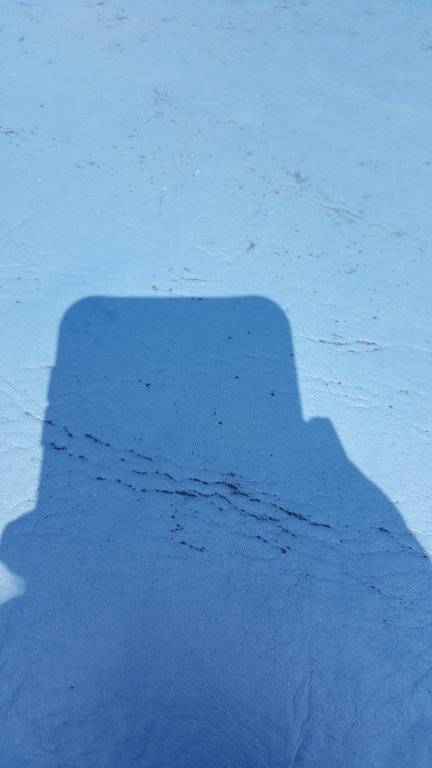

I belive my mechanical/wrench skills are 2nd to none. However, when it comes to body, paint and vinyl....I suck!
I have some dirt on the new vinyl and I'm asking for recommendations for products and procedures to clean it up. Thanks in advance!
I am constantly told that my vinyl top looks immaculate. I take regular soap and water and use a sponge and scrub out all of the dirt, and then let it dry really well. Then take a bottle of baby oil and rub it into the top and let it soak up as much as it wants. Clean off the excess, and then buff it to a nice shine!
Bob, that looks like mold. Hit an inconspicuous small spot with bleach and see what happens. Been under a car cover, yes?
Or try "Fantastic" with a stiff bristle brush or an old tooth brush. There are several products out there to coat and protect it.
Never use bleach!
I remember doing this "back in the day" on a silver vinyl top. Car was about 2 years old. Within a year of the bleach treatment, it turned yellow-brown, and started cracking . . . before it disintigrated.
Bleach and vinyl do NOT play well together . . .
I used Simple Green on white conv. tops with good results. It'll remove mold and not harm any paint or plastic trim.
Thanks everyone.
I'll tackle it in the morning with a toothbrush.
