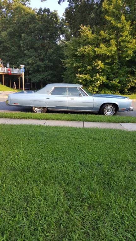

I'm going to be looking at a Formal Era car soon that has a vinyl top. From pictures there appears to be some discoloration on the lighter color top near where the top meets the windshield.
How do I try and determine what is going on underneath the top and what that will eventually mean to me in terms of repair?
