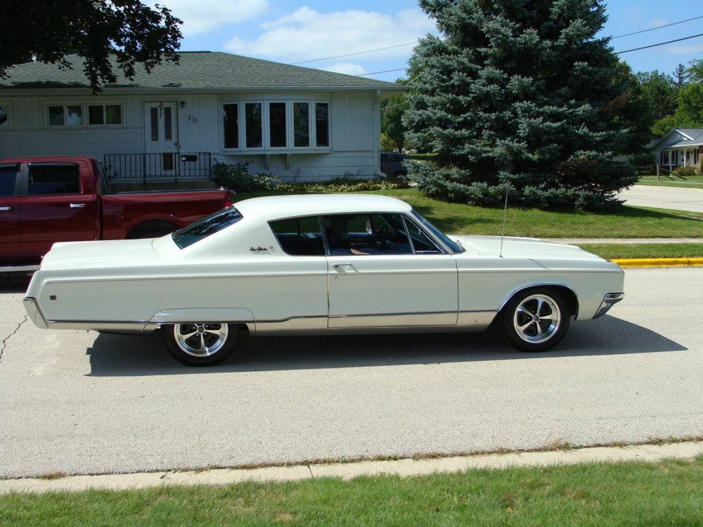

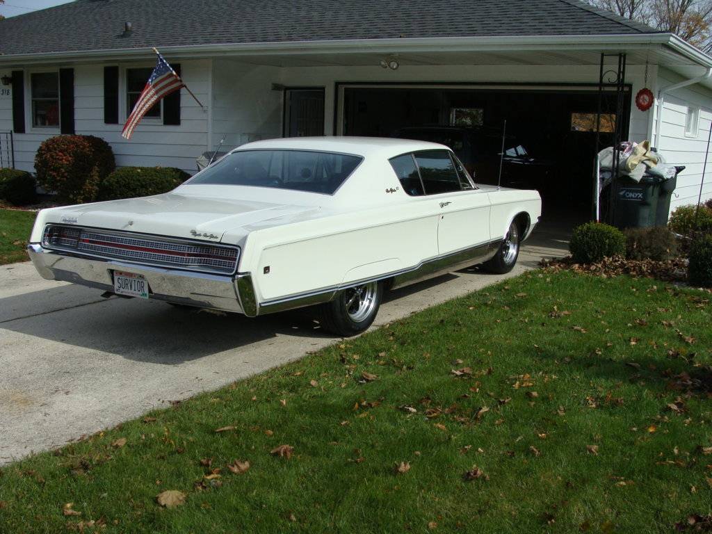

Here's my 68 NewYorker, sorry no fuselage but perhaps this will help
