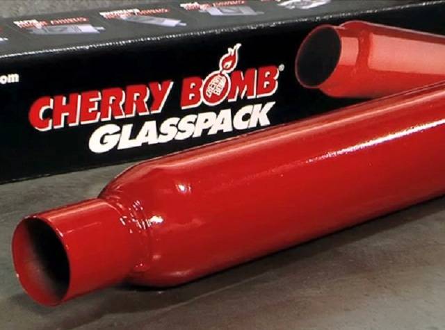

    I remember all these round tube mufflers, and of course Cherry Bombs seemed common.
    Were the stock c-body mufflers the tube shaped (like cherry bombs) or the flatter oblong ones like some of the flow masters I see listed?

    The "round tube" mufflers were all "glass packs", unless they were a factory rear resonator (with NO fiberglass packing in them). NO OEM used glass packs as factory equipment.
    They were allegedly better for decreased back pressure, BUT that was not a universal situation. The slots in the internal tube could be angled into the exhaust flow rather than otherwise, for example, or the inner tube could be smaller than the inlet size. Back then, it was more about "the sound" than real performance, I believe. Back then, if it made more noise, it made more power. They were also more inexpensive, which was a major factor, too.
