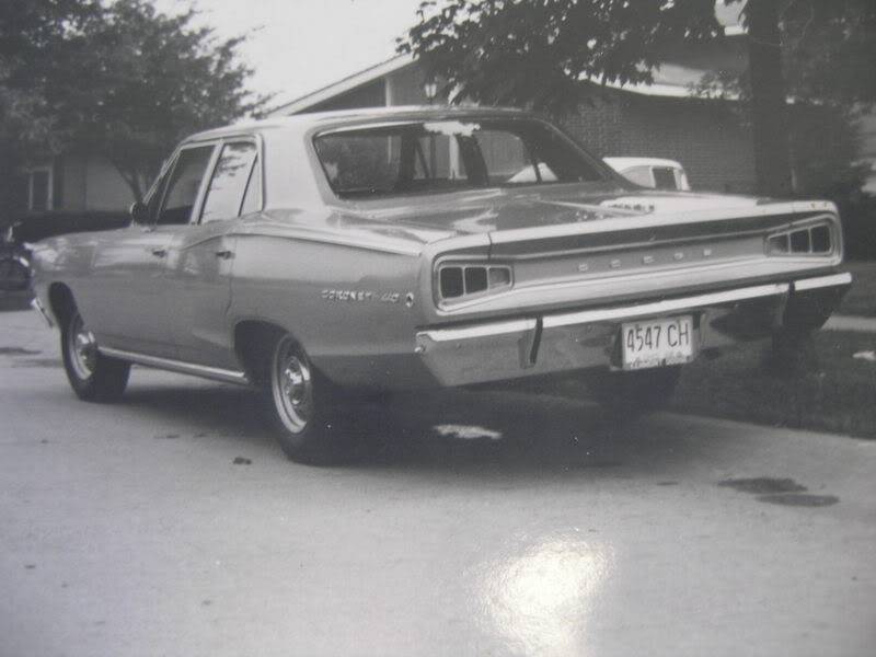

My dad ordered a 68 Coronet cop car thru the zone manager and it came with one. Fun car to drive.
