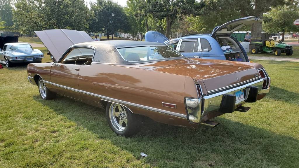

Yes rear end gears make a big difference. And 2.7 will hamper performance. Same with tire height, it affects the gear ratio. How tall are those rear tires? They look tall.
And you will want lower gears, which have a larger number.

I already have duals with short tube headers running right now. Thanks for the info. I don't really do any open road driving, if I do, its short.
Those in that pic are 22"s but that was only for messing around. I normally run American Racing 17's, you can see in my other reply.
The overall tire diameter is the key number you want to be concerned with, not the wheel diameter.

As Big_John suggested, I would agree that a swap to an 8-3/4 rear end would be a plus. I'm running 235-60/14's and a 3.23 rear. This suits me fine with good highway revs. Since you are running 235-55/17's, and you say you do very little highway driving, you mighe like 3.55 gears. This is only a suggestion and others may add thier suggestions. Lindsay
The referenced 17" tire size is pretty close to the G78-15 size the BASE non-a/c tires the Newports came with back then.
