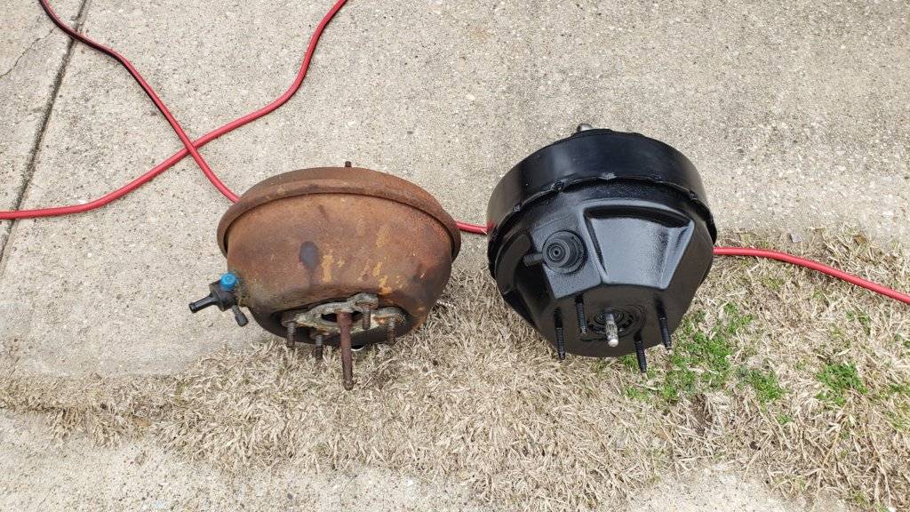

Hello, yes, my car has one, but I live in South America, it is impossible for me to send it to be rebuilt, I saw an option on ebay, but they tell me that it is not compatible, and in my country I do not find parts.
If you're that far away, he may send you a rebuilt one first (and charge you for a core), and refund the core charge when you send your original to him after you've received the good one from him.

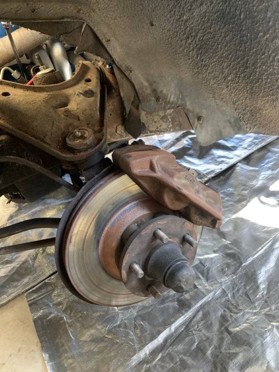

You can also buy the right booster from Rockauto.com I replaced most of the brake components on my 67 T&C, the rotors and pads i bought from eBay.

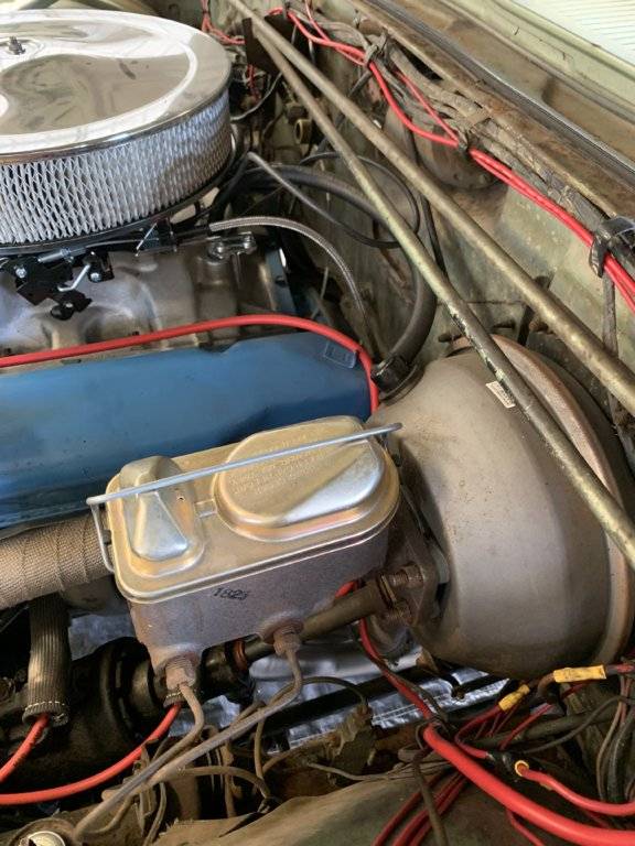

Oh dang that sucks. I bought mine a year ago. Looks exactly like the original. The master and booster in the pic are from rockauto. Perfect fit. Cardone is the company that does the remans, possibly get one directly from them on there website.
mine was from 1968 budd discs on a sport fury. the single was from drums on a 1968 fury III.
very interesting post Andrew if we can somehow demonstrate that is the original booster you have in that setup. you will stir up a lot of grumpy men in old hats.
