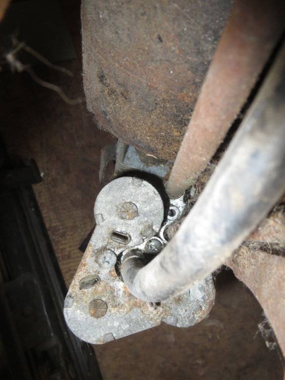

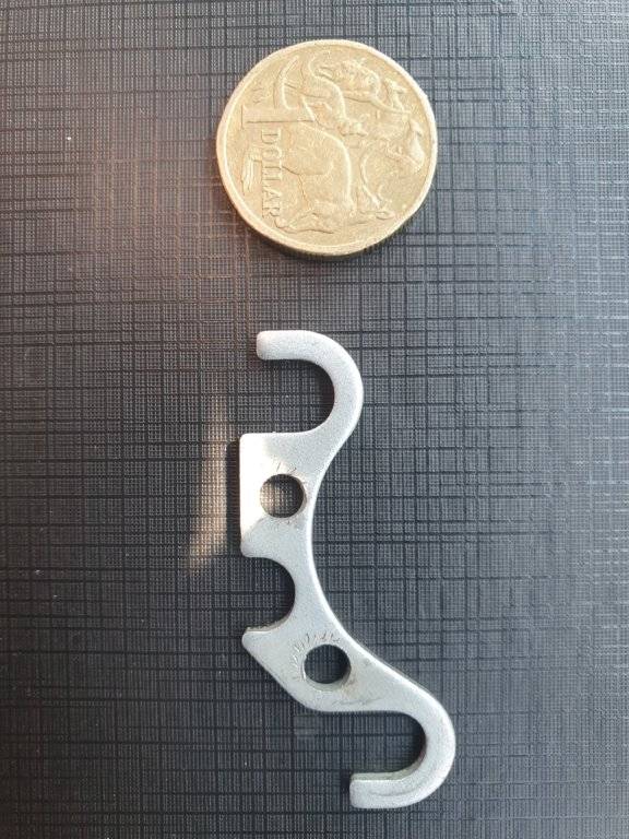

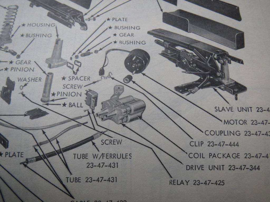

Hi, I am doing some cosmetic fix / clean ups on my 68 New Yorker,
I am looking for the little brackets that hold the power seat cables into the power seat motor/gear assembly, 2 cables go in in one side, 3 on the other, i need the one that holds the 2 cables in,
I have attached a picture to show what they look like.
I would be happy to buy both brackets if anyone has any.

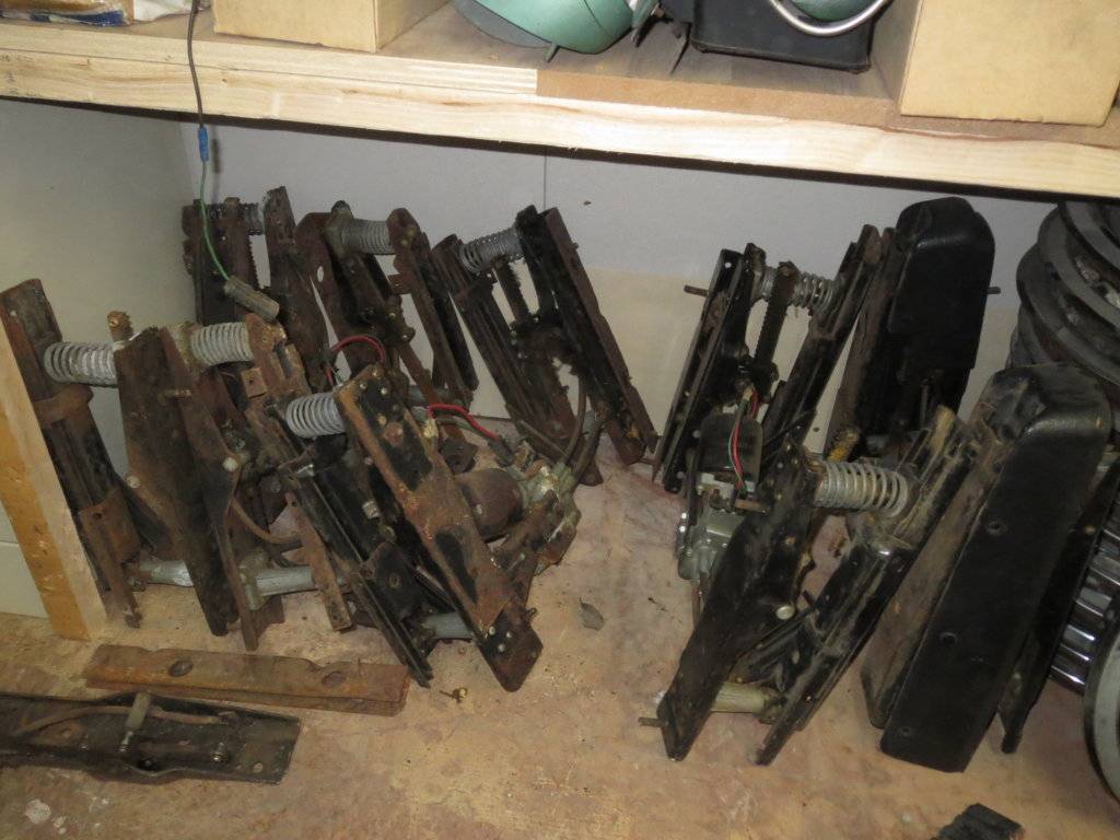

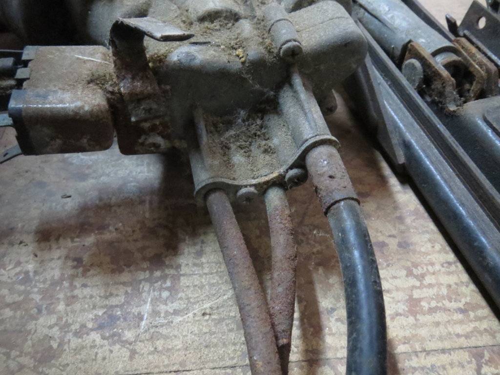

I don’t believe there is a clip on the other side where the 2 cables go in. I looked at every one that I have and none of them have a clip there. The fact that the Motor is mounted directly to that side of the power base and those cable are inside rigid tubes means they can’t go anywhere anyway.
