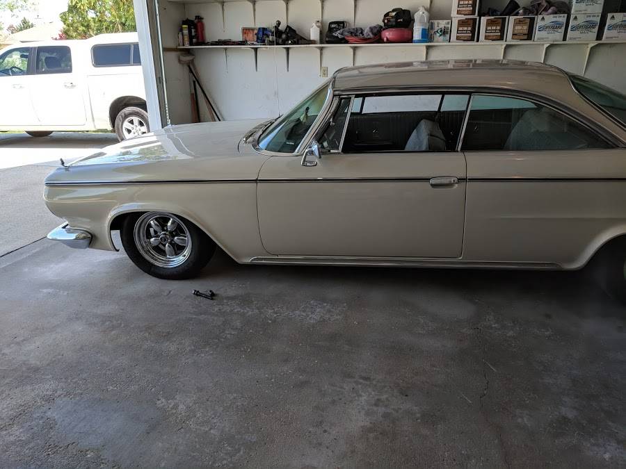

I was adjusting my ride hit in the driveway, wanted to bring the front end up another inch.
Passenger side was smooth, drivers side seemed tight. Instead of listening to the voice in my head to get the jack, I just keep cranking. BAAAAMM!!!!! Bolt was cross-threaded and finally ripped through the nut. Car slammed down with shoulder and arm under it. I was lucky as I had my head was under there 20 seconds before. I am still shaken.

Sorry about spelling, fingers still shaking. If anybody has a bolt and bar nut, I would be willing to buy it.
