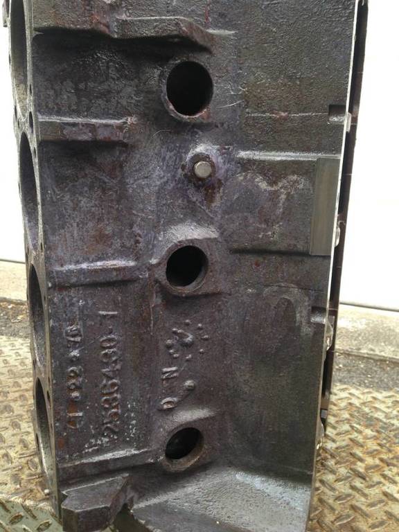

How could you tell it's a "warranty block"? I see the blank pad, but how do you know the seller didn't simply machine it and clean off the VIN?

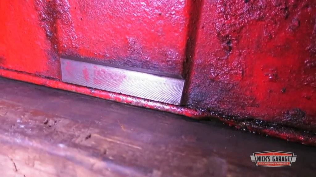

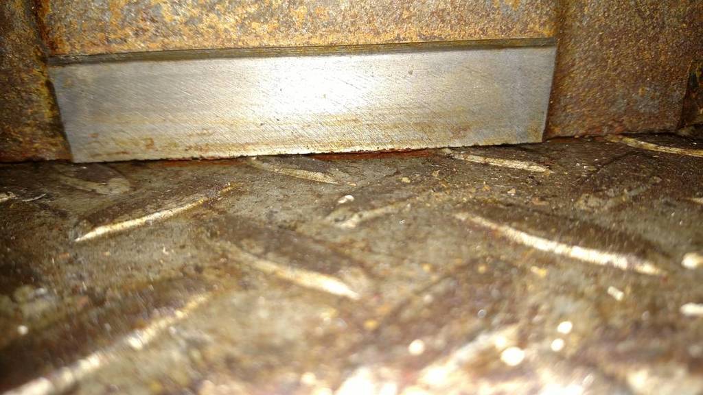

The short answer is you probably can't. This block shows a casting date that appears 7-22-70, right at the end of the production year. If this block had been installed as a production item in a vehicle, it should be stamped either with an "F" or "G" depending on when the 1970 production run ceased and the 1971 one started. Warranty blocks, and late production blocks produced at the end of a production cycle are not stamped until they are actually installed so that, for example, a 1970 block does not appear in a 1971 vehicle. Most dealers had the stamping kit to mark the warranty block with the correct details, but like everything else, a lot of them did not bother to do it. That is what I think happened here. If the pad had been machined off to hide an existing VIN number, the pad will show a reduction in height caused by the grinding process. You can check that against a block with a serial number to see if there is an obvious difference, but the factory machining process on the marking pads was not all that exact to begin with. Hope this helps.
Dave

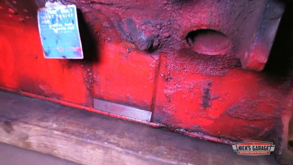

Note that the "Factory Built Short Engine" tag appeared on new replacement short blocks, it does not necessarily mean that the engine was covered under warranty.

Thanks, the seller is looking for a small fortune in trade, so it's not something I'm going for. I don't see where there would have been an extra tag mounted on this one, so it made me suspicious.

I think you might be getting a snow job, which is why he needs the plow. Without the "V" stamped code on the block, it is just another 440 block.

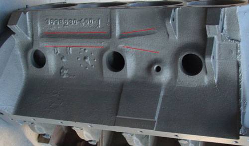

I think the ribs are there, it's just a bad pic, and hard to tell.
The rib just isn't there.
I've never seen a post 69 block without it, and everything that I just looked at says the same. Does that mean it wasn't cast in 1970? I don't know. I've learned "never say never" with this stuff.

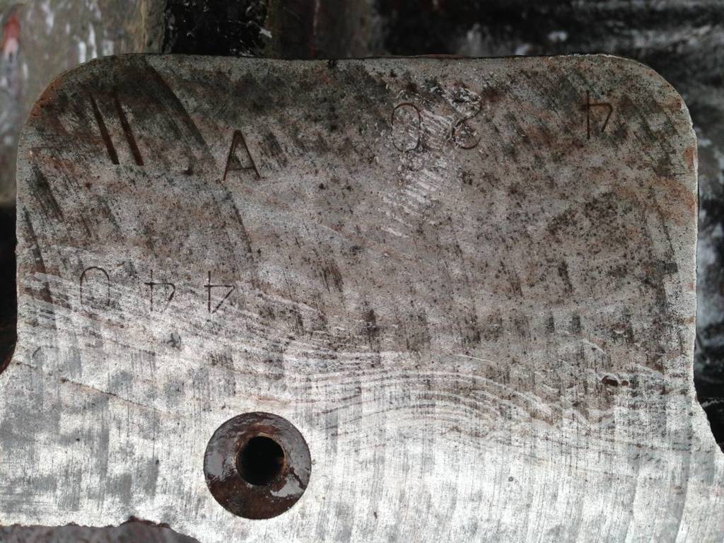

It’s not an HP block. Standard 440, so it’s not a “6 pack” motor. 4-20 Assembly date. With a .020 overbore “A”.
So since it has no VIN, but it does have an assembly date, we can assume it was a short block replacement. — 6BBL, Magnum, TNT, Super Commando,...not. If it had HP internals it should state so on the boss.

So that’s what the “A” means? I have that on my ‘69 motor.
There were many of these codes that could be stamped on the ID plate, the FSM gives the full listing. Covered things like over bores, undersized bearings etc that were necessary to bring the engine to specs at the factory.
