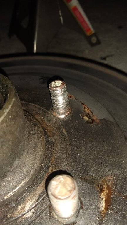

I was distracted, forgot to reverse the setting on my air wrench and annihilated one of my left-hand threaded lug studs on the front drum.
Don't people know that when you have the car out, the hood open... tools everywhere... the music cranking... and you're covered in grease.... YOU DON'T WANT TO TALK TO ANYONE!!!
So... I'm one stud short. What can I do about this? I'd like to keep the LH threads, can't seem to find the specs on the size and the depth of the knurled area either... if these things are even available. Or where I can get one... if they are the right one. I've been reading for a while... but mostly a lot of old threads about the same issues.

You can use a large drift punch to knock out the old stud and a brass drift to knock the new one in. Be sure to set the drum hub on a block of wood first when installing and the rear of the drum on wood also when removing. If you talk to your neighbor a lot, Lisle makes a stud installer #22800 that uses the wheel lug nut to pull the new stud into place. For sale on Amazon. If mobile parts does not have the LH studs and nuts, www.dorman.com still shows a listing.

Studs are 1/2" x 20 LH. Crown shows that stud JA000473 as the same stud for drum brakes. They only show it for Jeep listings, but I think it is the same stud.

Don’t start smacking it! You have to cut off the swedge or you’ll ruin your hub.

ok. Thanks. I've been reading up on how to remove it. Seems like a PIA, but can easily be done with patience and correct method.

Seems to be the bst way to do this is to buy one of these 9/16" hole saws, cut away the swadge and lightly drive the stud back out. I don't have a drill press, or any kind of press, so I'm doing it all by hand drill and hammer.
Was thinking of getting a piece of 4x4 and making a jig to rest the drum on while I work on it. Allowing me to drive the stud out without the strain on the drum once the swadge is cut away.
