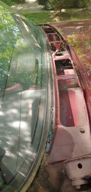

Or did a previous owner try to fix it?
I know i have lots of cleaning to do, vacuumed out all the loose crud that was in there
are those gaps supposed to be there with the windshield gasket/seal? I'm kind of want to do this on a budget, i have at my disposal with caulking and flex seal in a rattle can. I don't have the funds to properly get it fixed at this time. Just trying to stop/slow the water from coming in the driver's side
Looks the same as four '67's that I've opened up.
FWIW, I found using plastic scrapers or wood shims to remove the heavy stuff first minimizes paint scratch.
Depending on conditions, you may be able to use a wad of the mastic as a removal tool for the heavy stuff.
I wore rubber gloves, rolled it around in my palms, stick it to an area and pull off.
Same idea as using part of a sticker you removed to pull the glue residue off.
Stick, release, etc.
Then, after much experimenting, I found PB Blaster to work best for removing residue.
Apply Blaster to a rag and wipe a small part, then turn to a clean part of the rag and repeat.
If you wipe too much with one part of the rag, it will just start to smear instead of lift.
Takes a fair amount of Armstrong Elbow Grease, but the results are worth it.
Hope the input helps.
John

From what i saw, they didn't do a good job at sealing it with the mastic goo, and totally missed the windshield gasket.
I'm gonna have the same shop who did my floors in 2 days time look at that issue next year. But in the mean time I'll get around to cleaning up all the old crud and try to apply new mastic goo
Which would be better mastic caulking or mastic tape stuff? I have both in my stock atm
When i go to reply the mastic caulk it should be at the windshield gasket and the cowl gap?
I used goo gone and 3M general purpose adhesive cleaner, i I should have used goo goo to begin with in the first place would have saved a few more dollars :-|
Got the area all cleaned best i could and applied flex seal in the aerosol can with two coats of that. No water intrusion to be seen. Sealed up with 3M auto bedding and glazing compound and reversed everything back together
