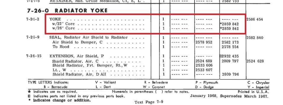

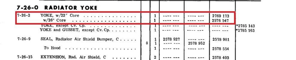

I don't have a good 68 parts book. The downloadable version is missing most of section 7. I do have a good 67 book.
Screen shot from 67 parts manual. This is the listing for the C bodies.

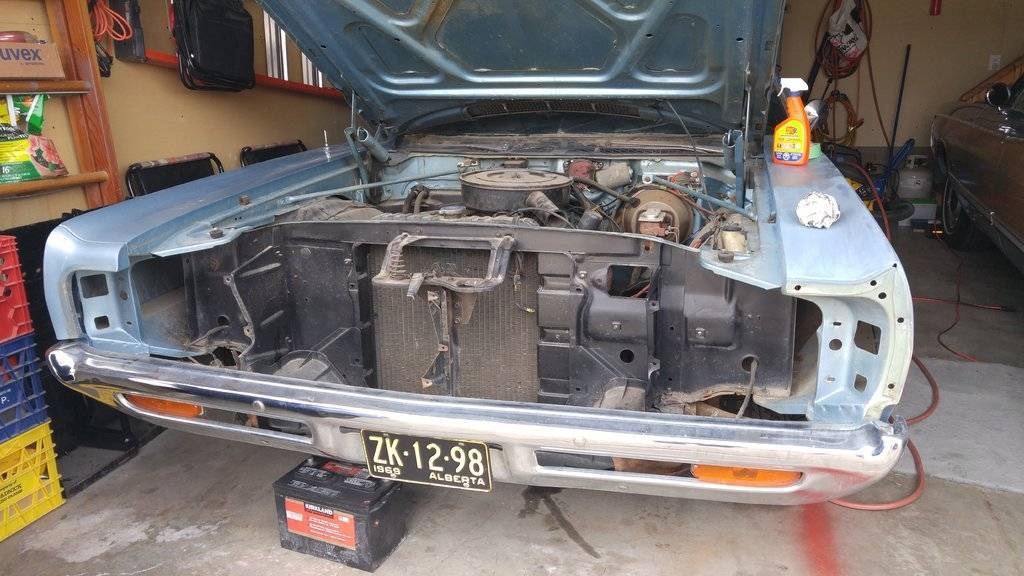

Here's my 69 Monaco 318 with a 19" rad and the bracket to fit the 22" yoke
Ok. Now Im wondering if I had a 19 and put in a 22. Now that makes sense. It was a base /6 car. When I dropped in the BB, it obviously was a 22 I remember as a 26 putting in. Just remembering smaller to larger - one support.
Mystery solved thanks to old men with hats.
