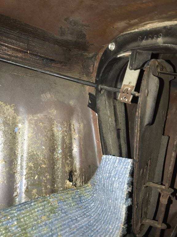

Cowl drains can be plugged up, if the drains are clear from experience heater box seals do become brittle and crack. Under heavy rain conditions leaks like you described can occur as did on my 300. Your 2nd pic shows rust stains to support this. DMT sells a complete reseal kit that works very well. Keep me posted on your results.

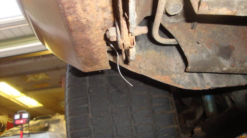

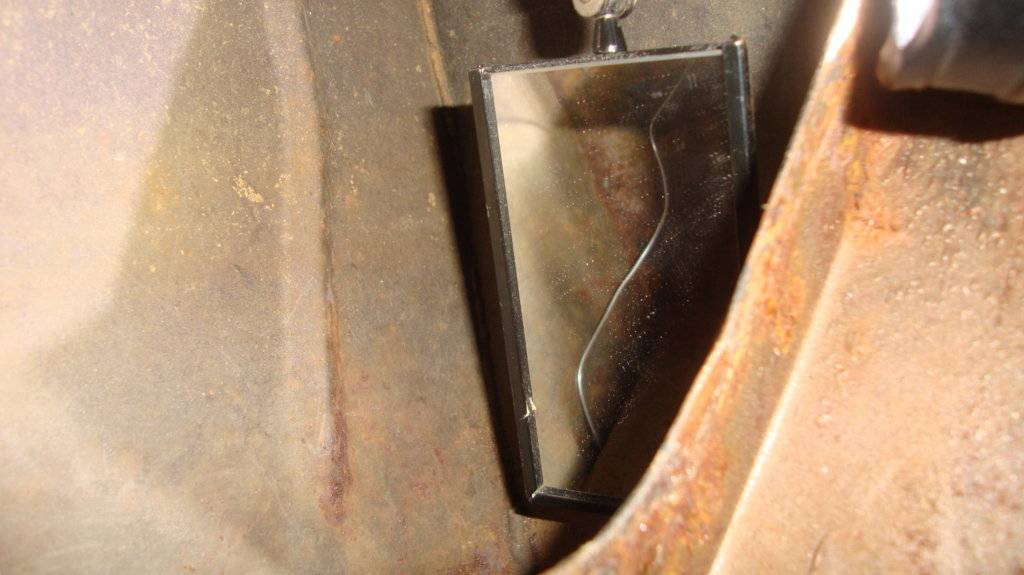

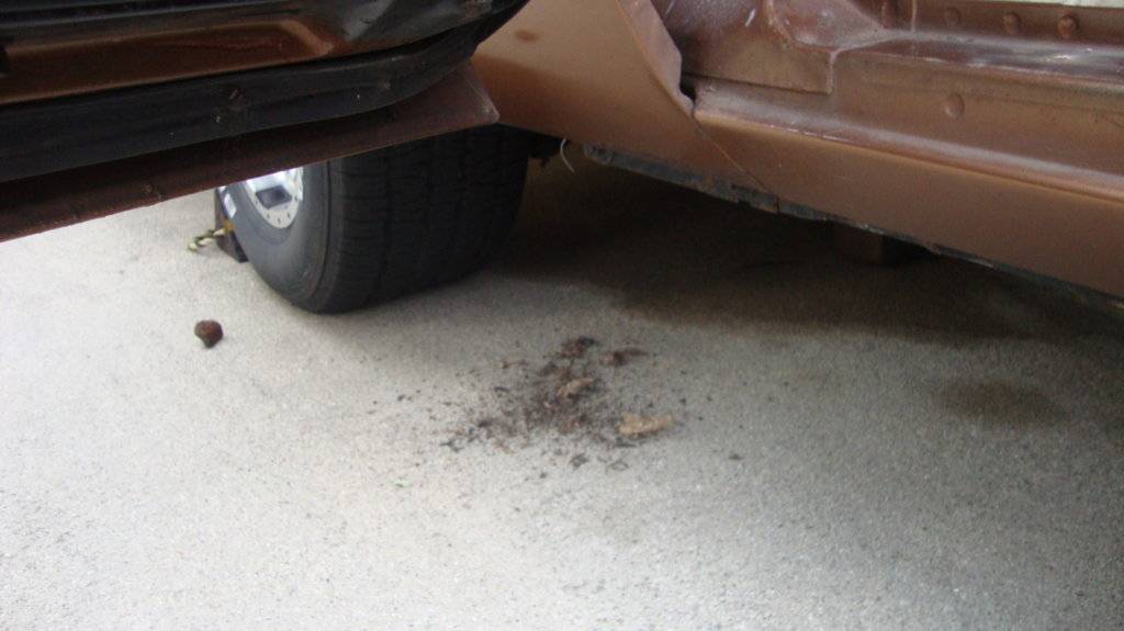

I realize mine is a 69, but I used some mechanic's wire and shoved it up in there and cleared a lot of it out. Also shop vac'd the cowl pan area in front of the windshield.
