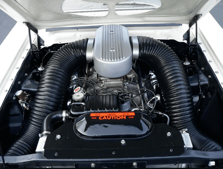

Have you tried other more simple things like colder spark plugs, or even a "cold air" intake that sources air from outside of the engine compartment? Maybe something like the Ford Thunderbolt setup.View attachment 213171
The cold air intake is what inspired me down this path. Here in sunny, arid Toostoned, swamp cooling works! So, how to get "cold air" into Tilly's carb? Nice to scoop it from up front, sure enough, but how "cold" is that air when the sun heats the asphalt here to near water boiling temperatures some days? Granted, its NOT boiling temp, but it isn't that cold either. Knowing first hand that the motor runs better during monsoon storms also put me onto the notion of adding a minuscule bit of atomized water into the fuel/air mix.
BUT, what will be the cost of such, both out of pocket and consequences to the motor. If its all rainbows, cool running, Peace, Love, forever, then more folks would be doing it, nicht wahr?
Yes, a cold air intake IS on my List of Possible Solutions, along with just buying premium petrol all the time and even adding Torco or such to every tank. But I like generating discussions like this ever so often too.
