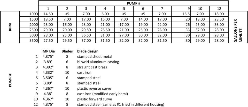

In another post I was asking some water pump questions and Big_John linked to this thread, start reading at post 191.
I took some of the information from this thread and put it in a chart to make it easier for me to compare. Here it is.
Thanks for posting. I would point out that chasing flow is not necessary a cure all. Higher flow rates are only effective if a high flow t-stat is also used. Robert Shaw brand were the best in the high flow t-stats. The factory did a pretty good job of mating pumps, t-stats, shrouds and fans to get sufficient flow with the appropriate air movement thru the radiator to get adequate cooling.
Dave
I posted about this on the C-body Dry Dock years ago. I had a pump like #2 on my 451 stroker. Always had overheat problems at idle and stop-and-go traffic. 3-core 22" rad, Flex-a-lite s/s flex fan. Added a fan shroud which did not help. With the fan shroud it took longer to get hot, but it still did get hot, and once I got moving it took longer to cool down.
Then I found the same water pump flow rate study that you did, and saw that my pump style was WORST performer of the bunch, especially at low RPM. So I switched to a Milodon high-flow pump with anti-cavitation plate and high-flow thermostat which they recommended. That completely solved my overheat problems.
