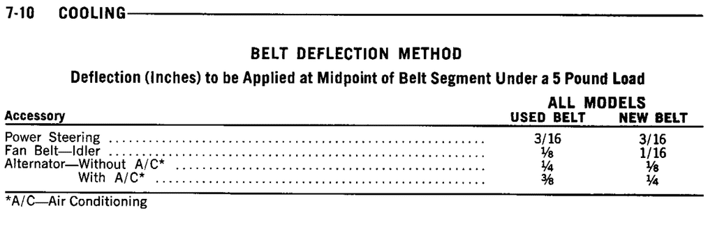

My 66 original blew the bearing out at 43 years and 96K miles, replacement was made in Japan. That bearing took a dump at 8 years and 20+K miles. Both blew out on the highway! My current one is made in Mexico, we'll see how that one goes? Am I over tightening the belt over stressing the bearing, or using inferior parts/products?
I can't answer your question, can you answer mine? Good Luck
Hang a 5 lb weight off the alternator to waterpump belt if you're AC free- or use a 5 lb pull from a fishing scale at the midpoint between the waterpump and idler pully if you have AC, then measure the belt deflection. Without AC, the deflection should be 1/4 inch. With AC, the FSM allows for 3/8 inch, with "used belts." If your belts are tighter than this, you may well be over stressing your waterpump bearing!
