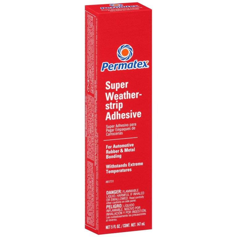

I have also used this with success on door weatherstrip
Permatex 81731 Permatex Super Weatherstrip Adhesive | Summit Racing

I'm restoring a 1971 Corvette for a friend. The rear window gasket is glued in and screwed in a few places from the factory. I used Permetex first, it dried Rock F*&%ing solid before I got the the bead all the way around the window frame. I had to use a mixture of gasoline and razor blades along with a wire wheel to remove it. I was highly pissed. I promptly threw it away I ordered 3M and it worked great. I would try a small piece on something else just to see if you have the same issue again before you start with a new product.
