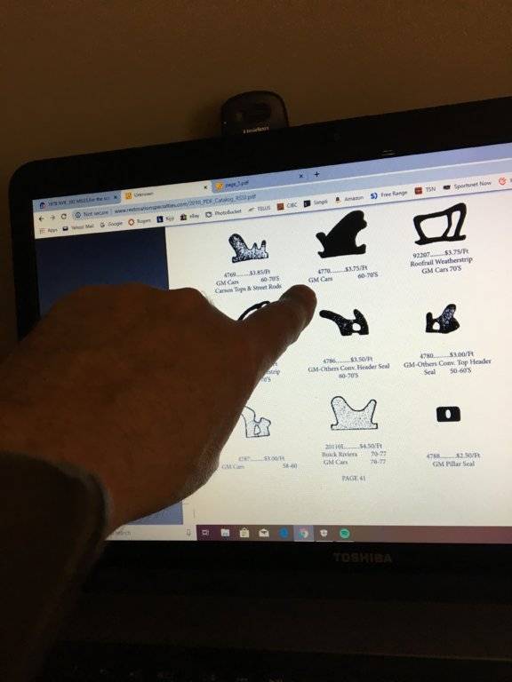

So sorry Peter for the ridiculously long time replying. The extrusion is 4770, not sure why Matt could not find it. It’s on page 41 of the catalog.
On your question of 2-door over 4-door. The weatherstip is an easier install on 2-door as you won’t have to glue in the C-Pillar extrusion. It just extends into the C-pillar.
As a side note, the 2-door and 4-door are identical in length and should be interchangeable except you would have to glue on the C-pillar 45 and extension.
Hope this helps.
I’m so sorry to have been this tardy replying to my own post.
To the questions of 2-door vs 4-door. Originally I never bothered with the 2-door cars as a source for weatherstrip parts but then I pulled one to find that, except for the C-pillar extension, the 2-door weatherstrip is long enough to reach the 4-door turndown for the C-pillar extension.
In other words, the 2-door weatherstrip goes along the longer glass and buries itself about 6” into the track and stops, no need to turn down the C-pillar. On a 4-door you could use the 2-door, just attach the C-pillar extension.
