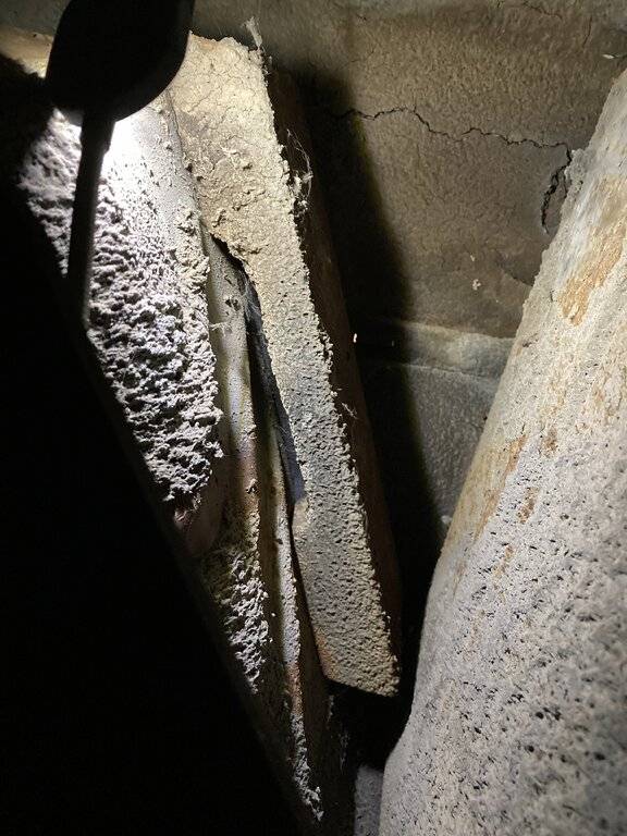

Asking for a fellow Imperial owner, who has a '66 convertible.
In each side in the very rear of the car, it has what appears to be a cast iron weight or block. They are attached to the outer bumper bracket and the floor.
Can anyone explain what the purpose of these is?
(I am guessing it is related to vibration or some other vehicle dynamics, but please enlighten us!)

Same on the ‘64s as well. They are convertible only and there’s also weights in the front corners as well however I haven’t yet been able to put my eyes on them. They are for dampening vibrations.

Thanks a lot to everybody who replied!
The thought of adding more weight to an Imperial seems crazy. I have never seen a car/frame so heavily built and the steel used are of extremely tough quality (I spent 2 hours to correct a bent flange on a body-mount). But I can see a convertible having less rigidity in the vertical plane.

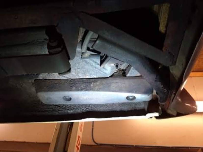

Matt, If you look straight up in front of the front splashshield, they are bolted in above the headlight surround. The bolts are behind the grille, with a reinforced bracket to hold them. My replacement fender came from a 4-door, and I had to redrill the bolt holes in the headlight surround to mount the block.
The couple of times I looked for it I didn’t know I was looking right at it.:rolleyes:
I have no idea what you people are referencing.

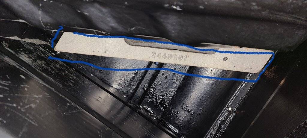

I understand that there is a chunk of iron in the picture, but it would be great if it was highlighted or pointed to in marked up picture, for us slow ones...
In Tommya’s post it’s the silver piece with the part number and in mine it’s covered in undercoating. Both are just behind the headlights.
