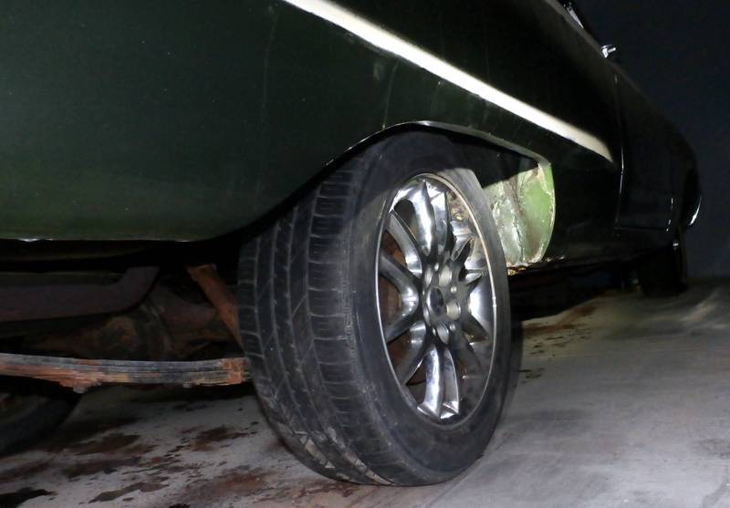

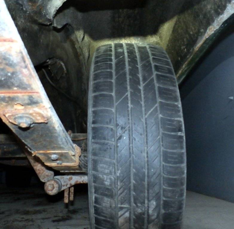

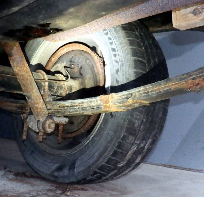

The wheels / tires from a 300m (225-55-17) will fit on the rear of the '67 Monaco. Tire diameter is really close to original (G78-14), but is wider. Eye-balling it, tire is centered in the wheel well, with room for a finger between the backside of the tire and the leaf springs. I'll be trying the fronts next, doesn't seem that anything is in the way on the front half of the tire, maybe the tie-rod will interfere on the back half.

Well, I can't put these same wheels on the front. The nose of the wheel drum won't go through the hole in the wheel (even if I take the center cap off the wheel). And at the same time the back side of the tire is touching the tie rod. The lug studs are about 1/2 inch from just coming through the wheel. So maybe an inch, inch and a half too much back-spacing.
Here are some photo's of the rear wheels.
