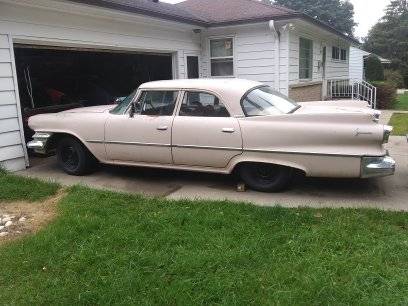

    Picked up this old girl and trying to find a little info.

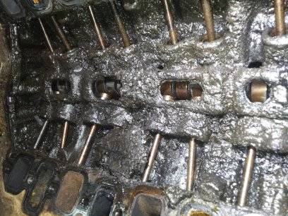

    It has poly 318 and I got it running after some work and engine smoked bad been sittings since mid 80s. Trans shifted good. Pulled the intake and found this.

    I looked at your other postings, and wanted to say... this is/was pretty typical.
    Old motor oils were valued for their paraffin content, making PA crude an desirable motor oil base. Lots of chemistry I'm not explaining and more that I don't fully understand, but back then it was pretty common to see an sludgy engine like this on disassembly. I had lots of valve covers I took off that had so much the rocker imprints were visible. As motor oils became cleaner and additive packages improved, this became a less common sight.
    You'd clog the heck out of some oil filters, but a lot of this would actually be cleaned up if you had run her with regular oil changes and newer oils... I believe the mess is still there primarily because she sat out of service for so long and never experienced the benefits of oil technology of the 1980's. I still remember how amazed lots of us were when taking off valve covers of engines run on good oils, compared to the stuff we usually found one older oils and iffy maintenance schedules.
