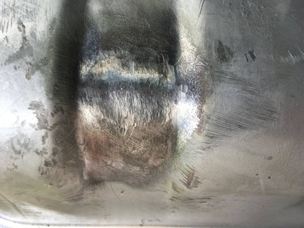

Does that sound crazy? It had been 35 years since I last did it but it still works.

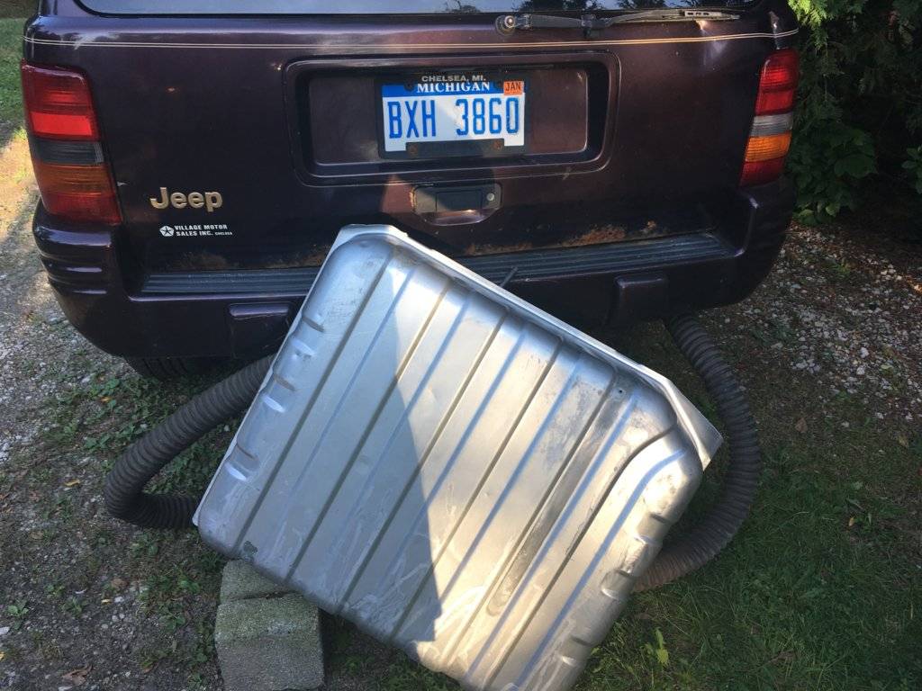

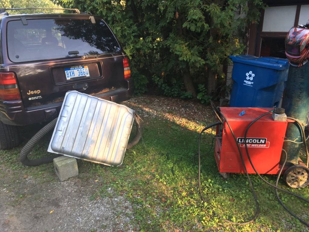

My uncle has welded sump on mine before. Old man way is to pump it with exhaust fumes, better hope you're not running Rich tho :)

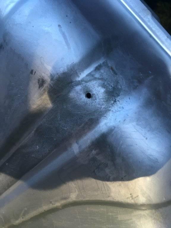

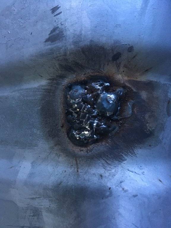

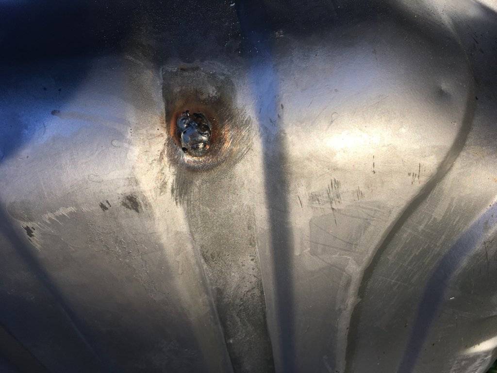

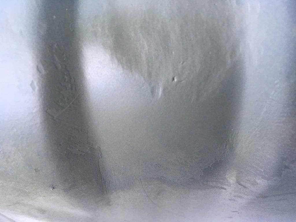

lol on the bullet hole. Ice pick did it. The photo was just the initial weld to close the hole. After grinding, I rewelded to make sure that all the margins are good. I’ve done this before.
lol on the bullet hole. Ice pick did it The photo was just the initial weld to close the hole. After grinding, I rewelded to make sure that all the margins are good. I’ve done this before.

I’m illustrating a technique that I learned a long time ago. I never claimed to be the prettiest welder. It’ll hold.

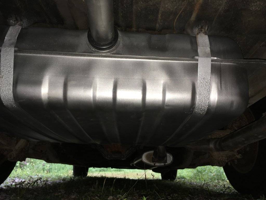

Is that the tank from the GTX? It doesn’t look like a B-body tank.
Monaco tank, just saw that in the other thread.
Being an imperfect welder, I have to grind and check any pits to make sure that they’re just shallow pits.
The point is to drive the oxygen out of the tank... gasoline fumes are about impossible to get cleared out. If the car had a running smog pump or misfire, it might bring the O2 level up to interesting...
I have never used a MIG, but I have soldered a few. I like the exhaust idea
I have a buddy who turns big propane tanks into charcoal grilles this way. Just run the engine long enough to push out the O2 before using a torch to cut the tank into a flip up lid, add a hinge and grille supports... he has an old boat trailer with 2 huge ones for smoking and a smaller one for steaks at the back. A popular item at big gatherings.
