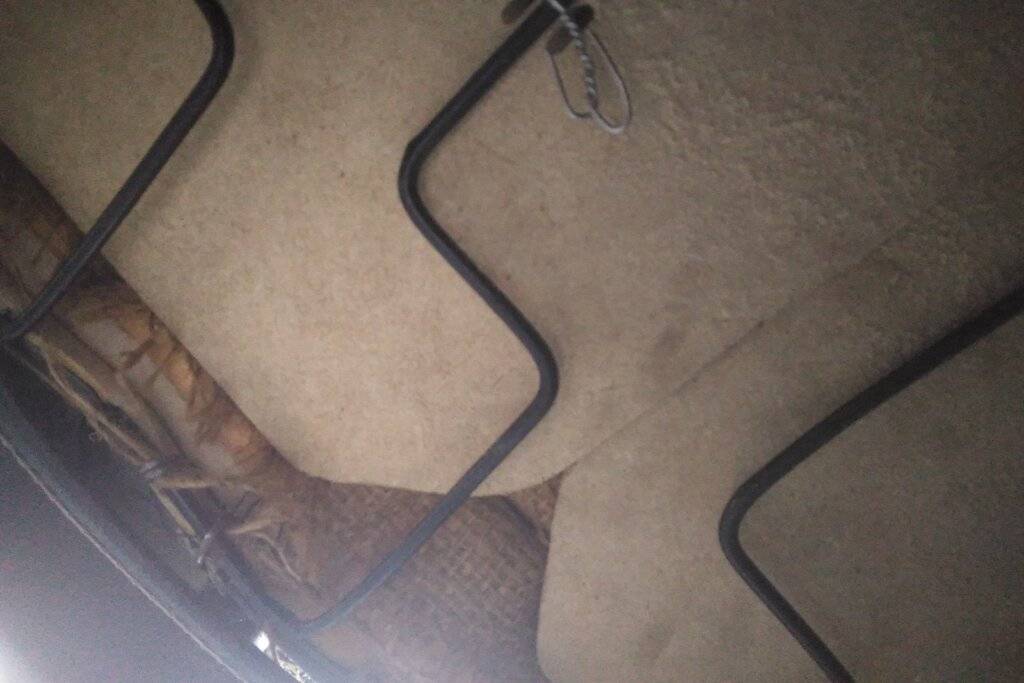

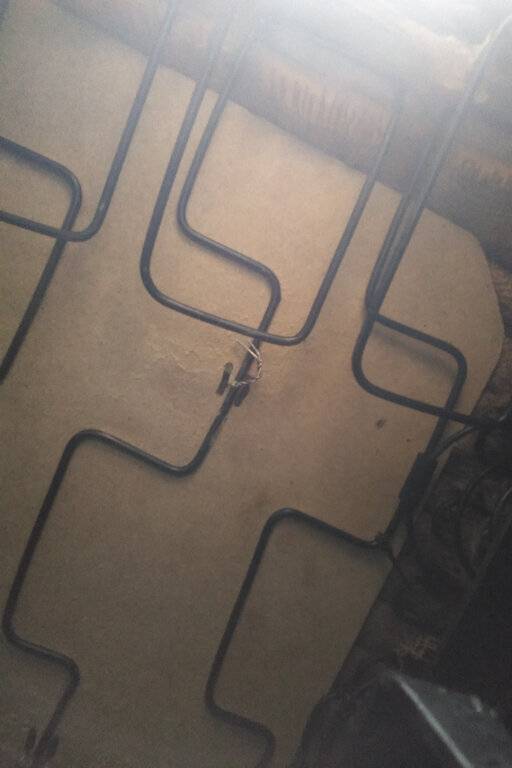

In the interests of time (as I'm trying to have this car read for a Memorial Day parade) I went with a variant of my original idea. HD wanted $33 for a 2x4 sheet of PVC, or $7 for the same size 1/4" Masonite board. I figured for that price and relatively little labor, it was worth a shot.
I cut the sheet into two pieces that were 16x24" and inserted them with relative ease. Then I wire-tied each in four places... and forgot to take a picture, so you'll have to go by what I captured sticking the camera under the seat.
The good: No more collapsing into the seat. Much better than before. Easily reversed with no harm. Not visible from above. $even dollar$.
The bad: You can kind of tell you're sitting on a board. They aren't uncomfortable, but it's more like a very good-quality folding chair. The webbing might be the best idea, but that will have to wait until I develop more motivation and find the time.

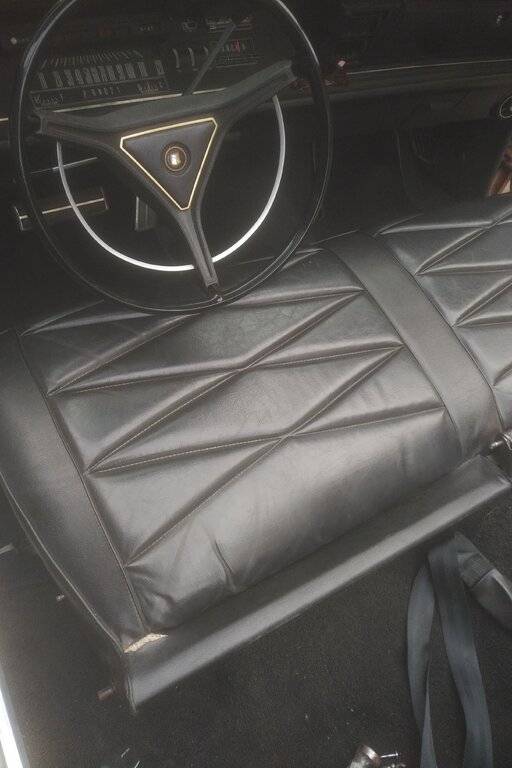

I'm out. My brain says 70 Newport just from the pattern, maybe 69 but my Dodge head isn't sure.
I cannot award you the winner's trophy just because you're culturally disadvantaged or get close. Even if such expectations reveal my bias and privilege.
