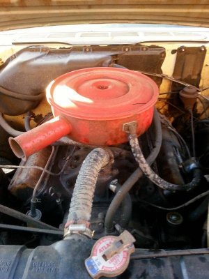

Before

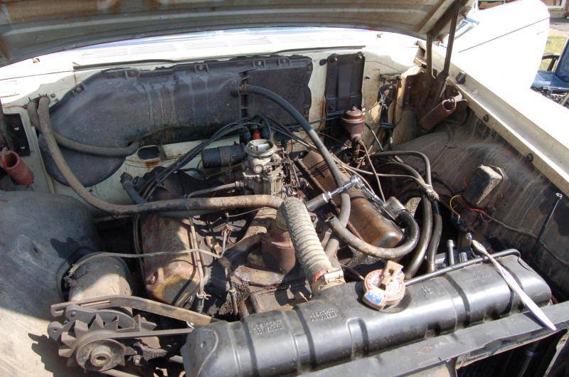

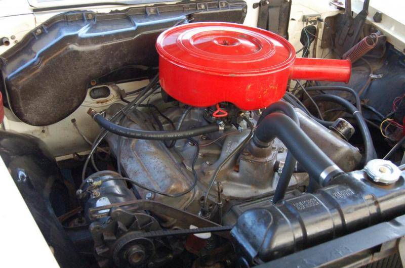

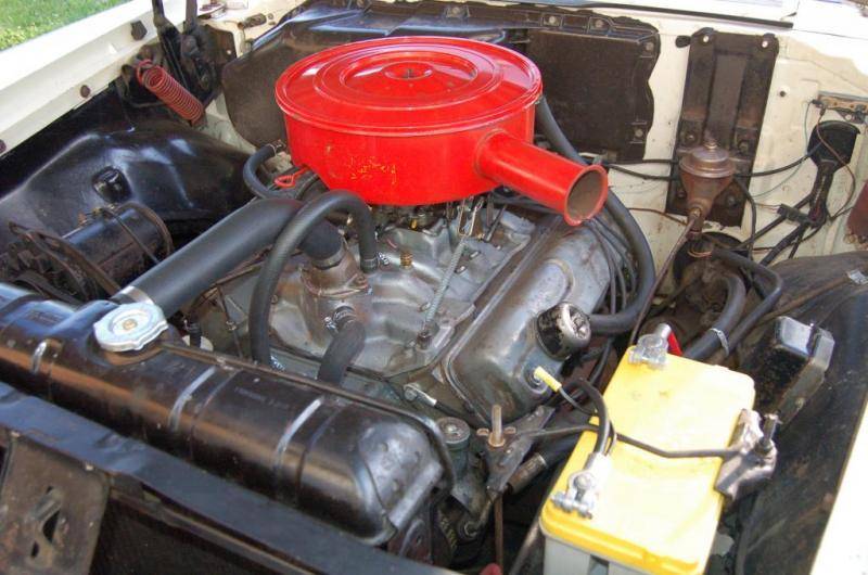

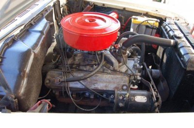

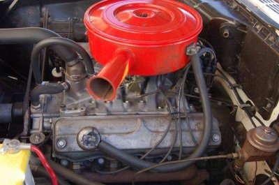

after
front motor 1.jpgfront motor 2.jpgLeft side of motor.jpgright side motor.jpg

The engine compartment looks good cleaned up. It can always be completely refinished at another time.
I like it. And it doesn't matter what anyone else likes as long as you are happy with it. I like that it looks like it gets driven and used!
I think there's something to be said about an old American car that is in good condition but "unrestored". That patina is part of the appeal for me.
