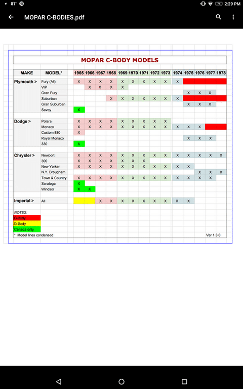

Stan's C-body spread sheet is the best tool for clarifying all the c-body models.
had a 68 imperial and it was a y body. c body parts wouldn't fit the front suspen. broke a torsion bar and couldn't find one. ended up junking the body. the body wieghhted 4800lbs. without the running gear. ctill have the 440 block in a 64 valiant
Sorry, but this has been covered extensively...your 68 Imperial (like mine) is a C body. The Imperial stub frame was different from other C's to give the 127 inch wheelbase and a cushy ride, as you found out, had different parts from the rest of the Chrysler Corporation car lines. That does not change the body designation of the car. Plymouth C bodies had different length torsion bars in some of the years too and that did not make them "P" bodies. Y was the car line. I have heard that the 80's Imperials were designated Y body, but I defer to others on that as I am not as savvy on the 80's stuff.
Commando's spread sheet is the closest thing to the definitive list there is out there.
