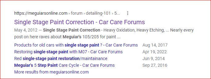

8.5 oz might work and will be enough to get you tired. But likely you will need a second. If you look at the meguirs forum you will see all kinds of processes that have been more tested than mine. I looked at them and created this version and am very happy with the results. I'm sure the guys here have many other suggestions with different processes, this is just one that worked for me.

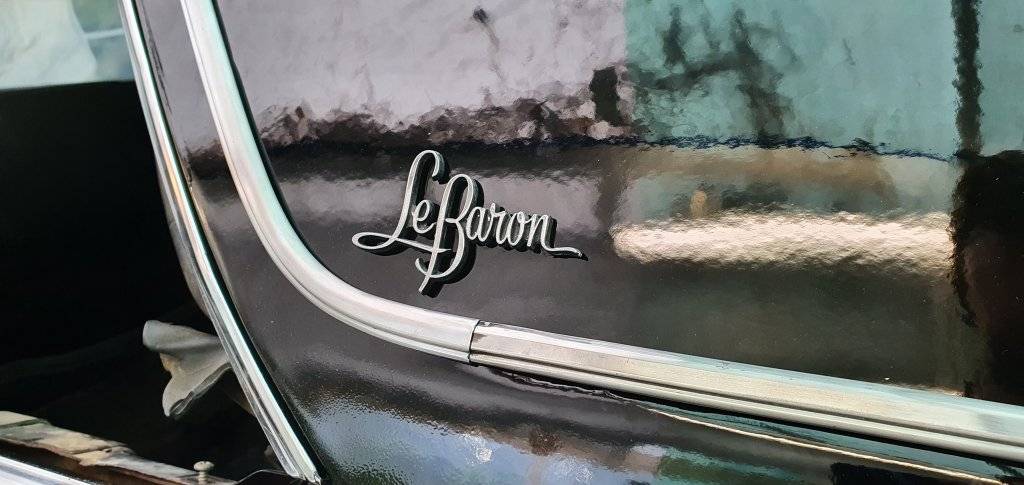

Was looking through my phone and I found that I did in fact take one detail shot. So, for reference, this is what I'm working with:
