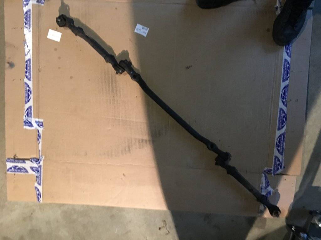

WHACKED!!! 1967 Monaco Tierod Assembly
GJS
Aug 10, 2016
4,570
4,554
Connecticut

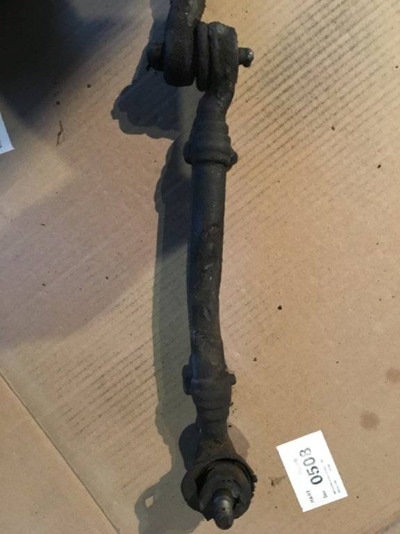

I pulled the remainder of my steering linkage out today and found some serious ugliness in the driver side tierod assembly. This likely ties back to the big dent in the cross member, the one in the oil pan and so many other things I've unearthed. I've already bought the inner and outer tierod ends already which sort of sucks as I know Firm Feel sells the complete assembly.
Just wondering if anyone has just the sleeve portion of the assembly in good condition?
Thanks all. Man, someone hit something pretty damned hard with this thing. Never take your C Body off roadin'.

I know mine never saw a junkyard. The most unfortunate circumstances she got into was as a sometimes high school car and then being with the last owner. He did her no favors and I'm pretty sure one of those transgressions was going off the road and not on purpose.
Better check your frame horns going to the bumper as these bend very easy.
Take it from me as I destroyed many a stub frame by just skidding off the road under full brake lock and not hitting anything other than burying the nose into the ground.
My 1977 PK41 wasn't much better, came over a rise in the road under full power, *** end kicked out, corrected, over corrected, spun into the ditch, may have hit some rocks and small trees sideways, powered out (thank you sure grip) preceded on only to have the steering wheel way off center. Off the the body shop to have the frame pulled back. Grrrrr.
Near as I can tell, the hit was on the crossmember. Rather sufficient dent in that. No evidence of anything screwey elsewhere in the frame.
Who knows tho? Gonna try and have it aligned soon. May find out some crap from that.
Well, I'm hoping this one is less of a sad story. Honestly, I'm not seeing any other frame damage and other than the slop in the steering, she really doesn't act too wacky. We'll see though!

You, being, the collective "you" or "you all" are NOT getting the "C" body sleeve --- in MOOG, or ANY Brand
Through Conventional methods Any Longer....
They have been discontinued, and are Obsolete, period.
Every now and then, some pop up on sleeze bay....
I have some N.O.S., but a very limited supply.......
