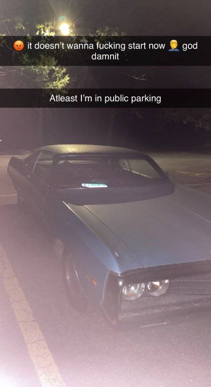

Well I know it’s been awhile since I’ve last posted, so I figured I’d fill everyone in. The car was finally insured and just got registered today! I was so excited I drove it around and had a blast. But two things became apparent, one this car suffers from sever wheel hop when breaking (I know this is common to this generation of c body and was curious if there was a more simple fix or any fix really). And finally two, that a car that’s been sitting pretty much for close to a year and that’s only been driven very rarely doesn’t wanna run forever once it finally gets the chance. I shut it off after driving for a good hour in a public parking lot and was either the victim of overheating, vapor lock, or a flooded carb, as the car would crank but wouldn’t start. So I locked her up, gave her a kiss goodnight (not literally) through some choice words it’s way for dying not at my house and found a way home. Until tomorrow my beautiful pain in the *** boat.

Ok can we get back to the basics? When it wont start, what happens when the key is turned? Does it just crank and crank but no start? Try cranking it and putting the pedal to the floor. That will unflood the engine if its flooded.
But I bet its vapor lock! Put a composite spacer under the carb. You can try to insulate fuel lines but generally with our ethanol fuel, a small electric pump by the tank will help a lot! You can even add this and retain the mechanical pump!

I think it’s much more than my original assessment, I made a new thread and yeah it’s sadly much worse. It wants to crank and start but it’s got some issues. I wanted to tend to these this weekend but I didn’t even trust driving it home. So I drove it a mile up the road to the local classic mechanic. I trust his work especially with classics.
