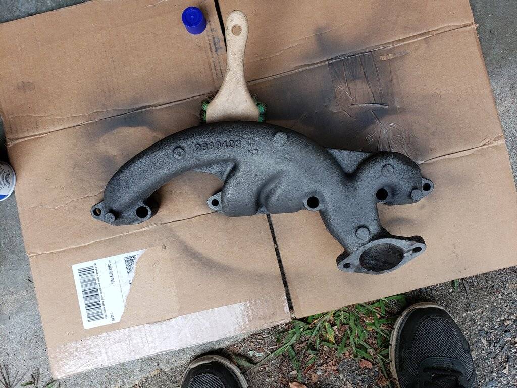

I'm going to try this old method on my HP manifolds. Graphite spray. You touch it up with a rag once a year sprayed with the graphite. We will see.
If you do that, make sure you are wearing clothes that you don't care about. When the graphite overspray/splatter hits, it's on there for good. DAMHIK:rolleyes:
Interesting ,I have done 2 manifolds already and haven't had that problem. I use dry graphite film lube and doesn't make a mess at all. No splatter.
We shall see how well it works. I first saw this on a Ford model t channel and the one I posted above. I thought it was worth a try.
Here is a pic after touching it both hp manifolds. See there isn't any splatter. I will give a report after they are on the engine awhile.
