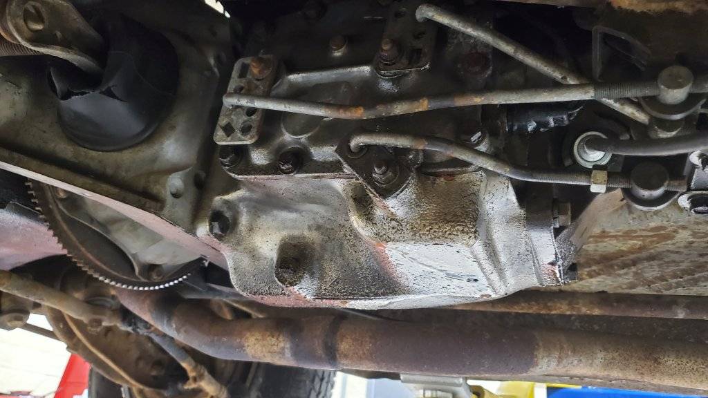

Need help who made this 4 speed need model numbers
The OD versions were allegedly less substantial than the original non-OD versions? Different gear ratios, too, due to the lower-power engines of the "OD" manual trans era. All were still 4spds, just that the original had 1.00:1 for the 4th gear ratio as the 4spd OD version had 4 forward speeds, but the 1st gear ratio was lower and the 4th gear ratio was OD at about .7:1.

The biggest problem with the aluminum case trans was the idler counter shaft was not bushed and ran on the aluminum. The shaft would wallow out the case. The iron case one used in pick ups I don't believe had this issue but the overdrive gear didn't like a lot of power ran through it. 1st, 2nd and 3rd are pretty much as good as a regular 833 so if you just use 4th to maintain cruising altitude, the trans can be very reliable. I know a guy that runs one in a restored Hemi 4 speed Roadrunner that has made several trips to Florida and Carlisle with no issues but he never stands on it in 4th.

The design was essentially the same, the 3-4 gears were switched so it could still be assembled the same way, that's why the 3-4 lever is pointed down and the 1-2 is up. Since the torque of the 225's & 318's was not what the big blocks used to put out some things like the type of steel used and bearings may have changed for cost reasons, not 100% on that as it was before my time at the plant. I never worked on the lines when I was there but it did stay in production at least through the 80's, maybe a bit beyond, in Chrysler and GM light truck applications.
I have a cast iron truck trans with long tailshaft. Most aluminum case trans were for A bodies or F bodies and used short tailshaft with cental shifter mount.
Long tailshaft version has both shifter mounts, forward and aft. I've put over 10,000 miles on mine behind a 440. Just don't sidestep the clutch pedal too much, and no full throttle power shifts. I would not be afraid of that trans behind a big block, just be ware that you will most likely have to replace it with a 5 speed because going back to a 1:1 high gear will not be a option.

So , it is an aluminum case and the passenger side stamping plate has the serial numbers ground off. The tail shaft housing is steel and it has a junkyard written in yellow marker 30 spline on it.....
