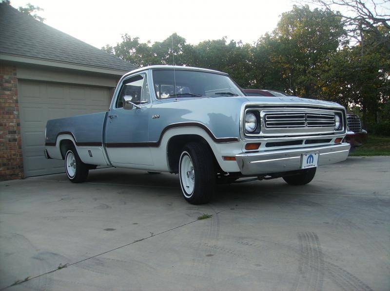

Commando is correct. I used Maaco on this truck below. But I sent them a stripped shell to paint with the body work done. I bought the "Premium" package that they had and it turned out alright and I'm happy with it.
