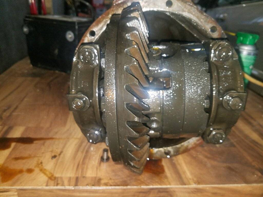

1965 Chrysler 300 I want to make sure grip. Where would you guys order from and besides the unit what else would I need? Going to stay with the stock gearing. 742 case
Is there anything else I would need to buy to make it work or just reuse the factory shimming and swap and ring gear over to it?

Just did some emailing back and forth with cass from dr. Diff and says if I'm just swapping in the suregrip unit should be straight forward just replace the carrier side bearings and swap over the ring gear. I will lay a pattern just incase but he seemed pretty confident.

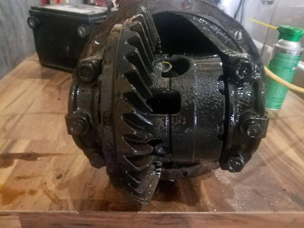

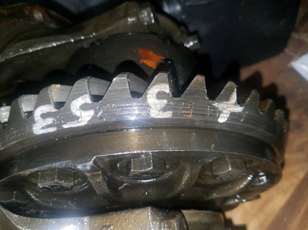

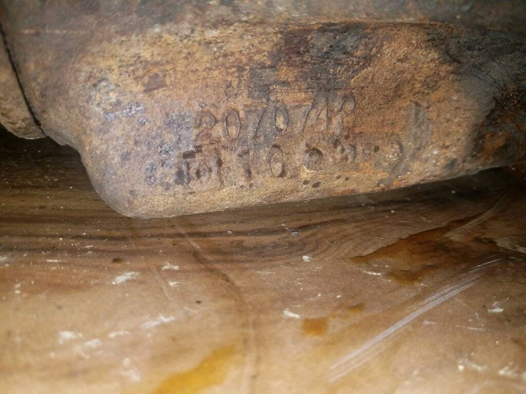

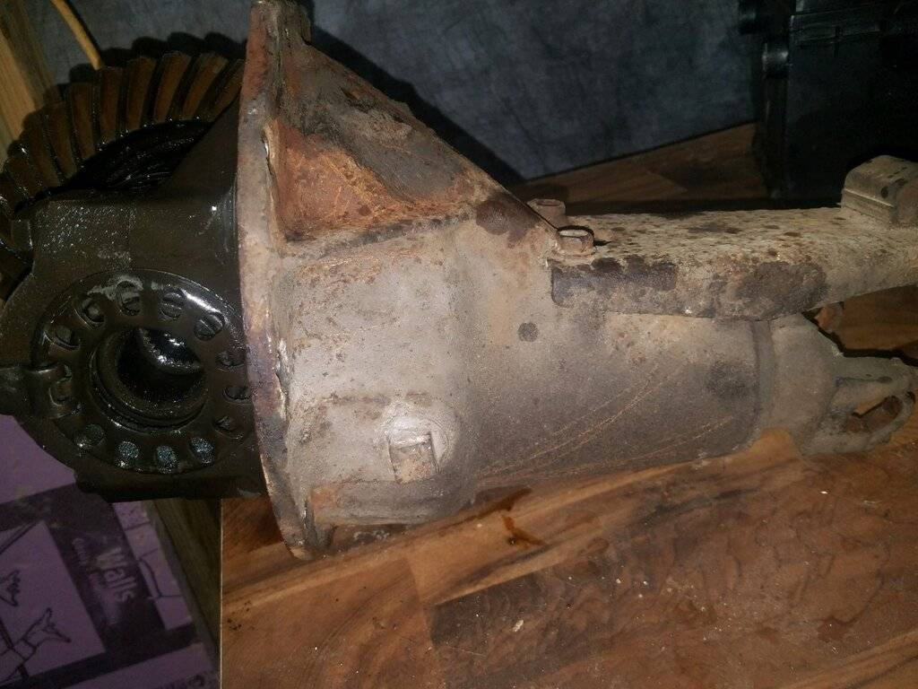

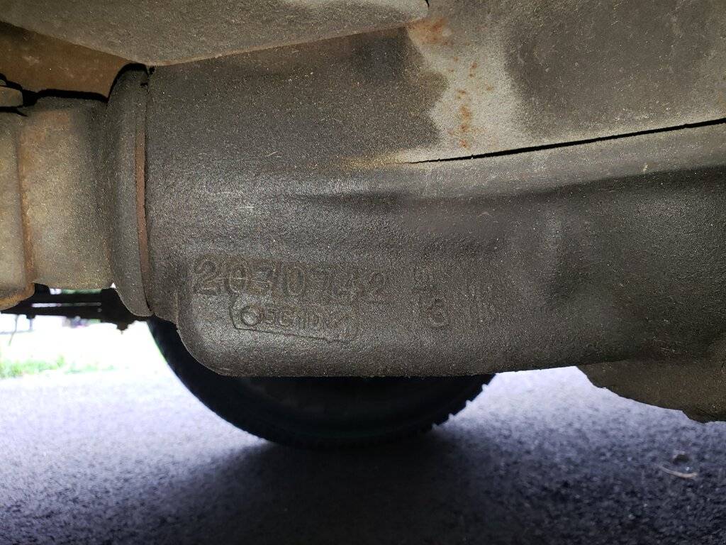

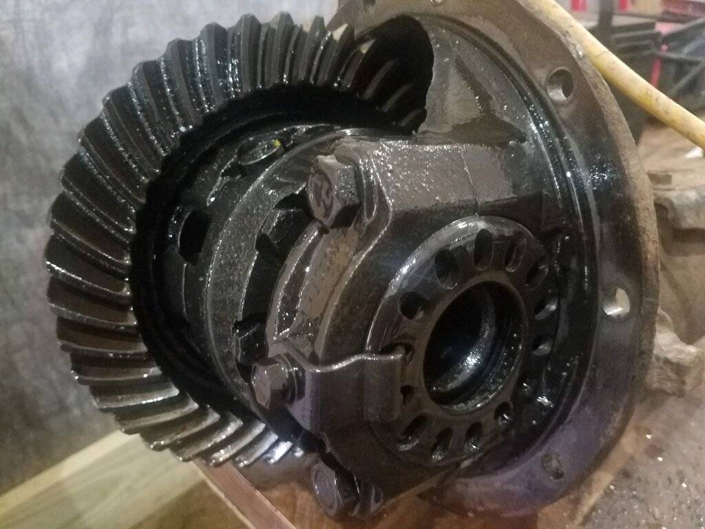

Do yourself a favor. Just buy a complete 742 center section and bolt it in. I have 3 for sale.
They are all Factory installed Dana power lock Sure-grips.Which were first installed in 1958 and used until 1972. The Borg Warner Sure grips "cone type" began use in late 1968. Dont buy them!
Do yourself a favor . Lookup Gary Lewallen .. AutoHobbyDigest Guide to the 8-3/4 . It is the best document to date.
Complete 742 suregrip center section with snubber and large yoke is 500.00 plus shipping. It weights about 87 pounds.
