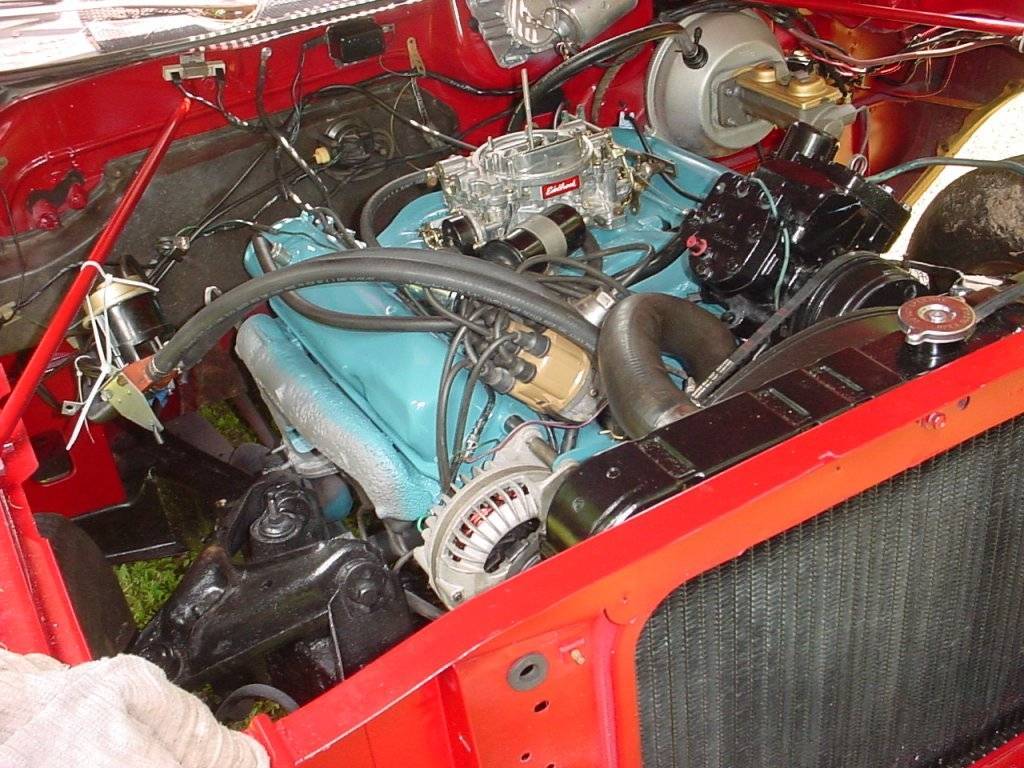

I put an Edelbrock 1407 w/electric choke on our 69 440. Runs smooth, powerful and economical.
If you are replacing, I second the Eddie 1407 from experience. I've heard a lot of good about the Thunder series as well but only have first hand with the Performer variety.
